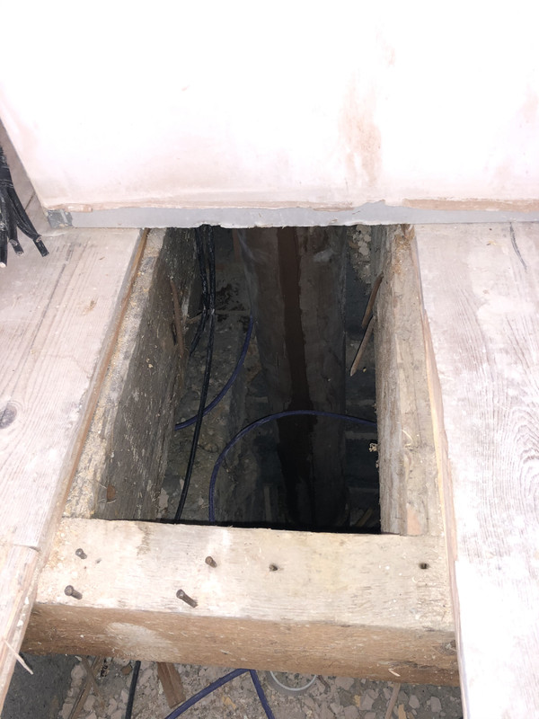

also from pic 2 I can get underneath that connection which is a orange pipe, that's wet all the way around as well.

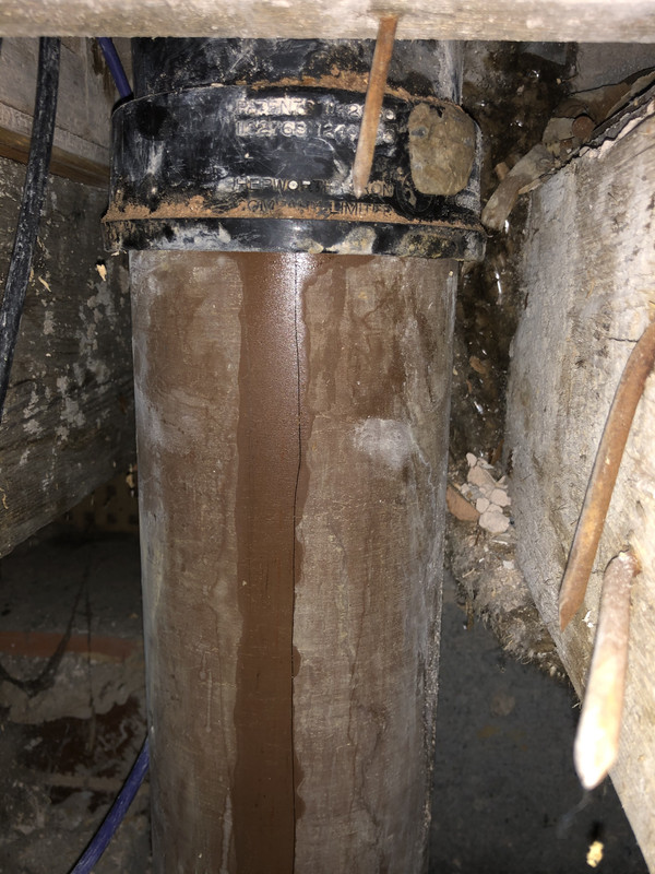

Orange pipe which comes up through the hole from under the floor has a crack right down it deffo leaking at least from the top half. many pointers on a repair job here please.
Looks like a lump of Supersleve clay pipe, to have cracked like that. If that's the case you have 2 options. Replace it or get it lined. If that is the collar just showing in the bottom of the photo, you may be lucky and be able to pull it out to replace it. If, (even better) you can get the collar off with it (or as well), replace the collar with a clay to plastic adaptor, and come up from there with plastic.
Otherwise, the drainage guys may be able to line it for you, provided they can get access from a suitable point.

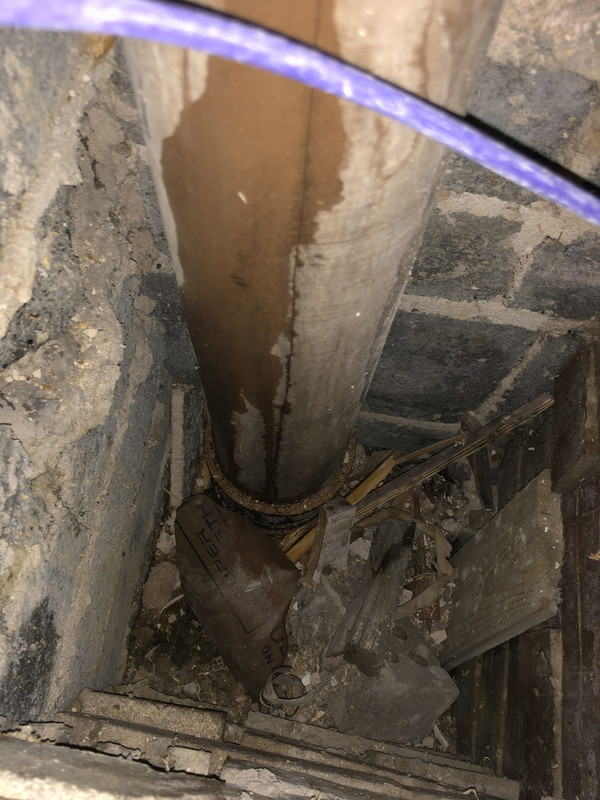

Thanks for the reply. One thing I know for sure is that I will not get to the bottom of the pipe, it’s too deep. pipe is clay orange with black centre and says super strength on it so Ye you’re right.
I’ve got some pics. The bottom seems like I’ll pull it out from that connection just fine , the top has a coupling on it too the black soil pipe.
could I break the pipe then pull the bottom out, then pull the top out and lose the coupler and fit a brown plastic pipe with the flange on it push the none flange side into the clay at the bottom and then drop the black into the flange of new pipe.
if this can happen my only issue is holding up the soil pipe while I’m fixing this, everything is under the floor boards and accessible but holding the pipe might prove difficult. I really font want too cut the boxing.

I'd have a go yourself, I think the hardest part is going to be removing that broken Supersleve.
Remove the existing clay pipe, but as Ian has said, be bl00dy careful, and I'd advise wearing gloves. (Cuts and sewage are not good together.) Make sure you dont loose any bits down the drain. If you can get bottom collar off, replace that with same as you got currently at the top, (wouldn't advise reusing the existing as it may leak). Fit new section of plastic in between and then use a slip coupling to make the top joint. If you cant get bottom collar off, then I'd fit a new section of clay into that bottom collar, cut and chamfer the top end as required, fit clay to plastic collar and make up difference with plastic, using slip collar at the top to join.
Whatever you do, make sure there is enough room to allow the pipework to expand slightly, push the plastic collar on fully home, and then pull it back a few mm. A frequent reason for a longitudinal crack is thermal movement somewhere and no room for movement on the pipework.
That’s what I’ve been thinking for a diy. I’m just trying too figure out how I hold the soil pipe up when I take away the bottom bit, it’s fixed too the wall but not too stop it drop. That’s where I’m worried about having too cut a hole.
I’ve never had a stack fall but there’s always a first time. It should be held pretty tight in its first connection upwards even if it isn’t clipped to the wall.
