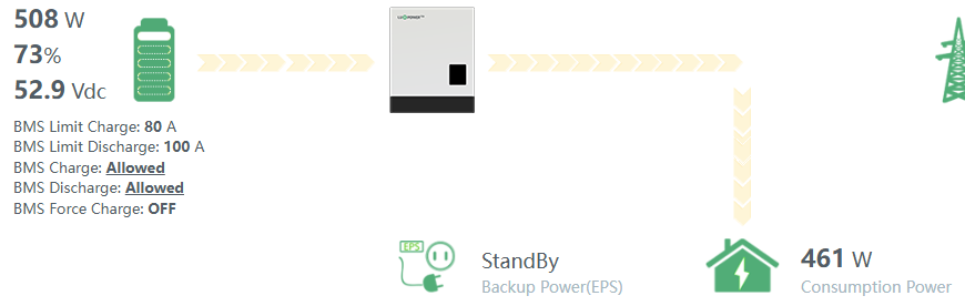

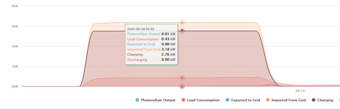

Was charging the batteries up during the night frm the grid (only 1.5p per unit) and with nothing else switched on in the house you can see the wastage
so 3.18 kW being used to charge the batteries by 2.76kW - 13% loss, so that headline price of 1.5p becomes 1.73p when the losses are considered !
wht charge through the night when you have solar? I can get 15p a unit exporting direct from the panels, so if I can import 8 kWh at 1.7p then that is an extra 8kWh I can sell at 15p

they are both very valid points, but if you look at a bigger screenshot you will see that the 'load consumption' rose at exactly the same time as it charged
esp looking at the bit above 02:05 there is zero consumption of anything (the fridge must not have been on)
there is a definite correlation with a load consumption of just above 400w just when charging - I guess this is losses going through the inverter

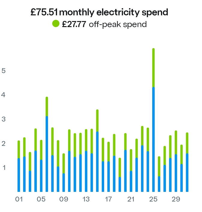

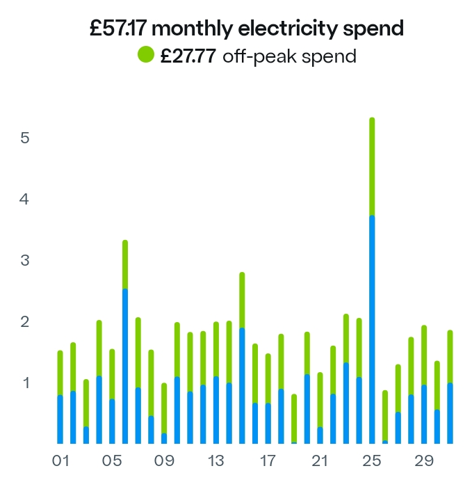

Last winter I was not being paid for export, and I was on 8.95p/kWh off-peak, and 31.31p/kWh peak. I used the data to work out what it would cost with a fixed rate. And it showed I would have paid at least £25 more had I used a fixed rate, as many days in the winter my solar production does not exceed used.
So December 2024
yes battery shows as charging 24 more kWh to discharging so clearly some loses. So the phone app shows 1748555283738.png without standing charge and 1748555369525.png with standing charge. So £75.51 total for worse month, year before did not have smart meter, so no off-peak, and paid around £100, and year before that more like £150, so the off-peak clearly cut my bills. But since export was only 13.9 kWh so just over £2 so I can expect the same cost this year, of around £75 for December.
I would be paying a lot more, if I did not have a battery and off-peak, but solar for month is likely only around £24 for the month, so mainly in winter it is the off-peak and battery saving me money, summer of course very different, this month alone around £127 produces by solar (at 15p/kWh) but need to look at the bad as well as good, and I don't want to be swapping tariffs, I now want to forget the electric bill been there, done that.
