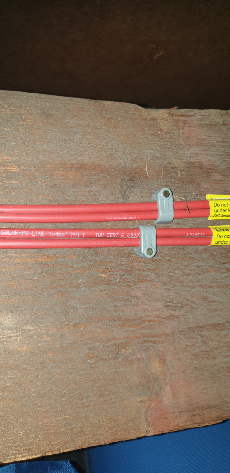

Hi all,
Can any one tell me if 32mm ducting is large enough to take the cable from 3 banks of solar PV each around 4kw to the invertor?
I am fairly sure it is but just wanted to check.
Thanks.

My first post may have been inaccurate as I stated that the cables would be running to an inverter which may not be true as I may be installing some form of battery set up so I believe that the cable would run to a controller before the batteries and inverter?
The DC cables start at different locations and run as follows....
A. Bank A will be 4m unducted in a cold loft then a bend into 4m 32mm ducted, this ducting will be surrounded by insulation in a plasterboarded ceiling but either end of the ducting will be open to the cold loft air.
B. Bank B will be 4m unducted in a cold loft,
C .Bank C will be 5m unducted in a cold loft,
D. The separate DC cables will then run through a single 32mm ducting of 2m (this ducting will be surrounded by insulation in a plasterboarded ceiling.) followed by a bend followed by a further 3m of 32mm ducting (this ducting will be in a plasterboarded stud wall but will NOT be surrounded by insulation) before entering the garage where they will exit the ducting and will continue for a further 2m unducted surface mounted on the internal garage wall .
The bends will not be ducted.
So longest run is for bank A will be approx. 15m.
I do have the option of combining the DC cables at point d within an accessible junction box into larger cables and running these through the ducting if that is allowed.
I may also have the option of placing the controller and/or the batteries and/or the inverter in the loft which could reduce the longest DC cable length to around 8m of which 4m would be ducted. I would then run 16mm? AC cable to the garage where my consumer unit is located.
I do already have a bank of 4kw on my existing house and this has 2 4mm cables that runs to the invertor. I have attached a photo.
I appreciate that it would make sense to get an installer on site to advise me but I am building a house pretty much by myself and the time scales between jobs can be excessive and hence installers are not keen to come out for a job that may not take place in the near future.
Any help much appreciated.
