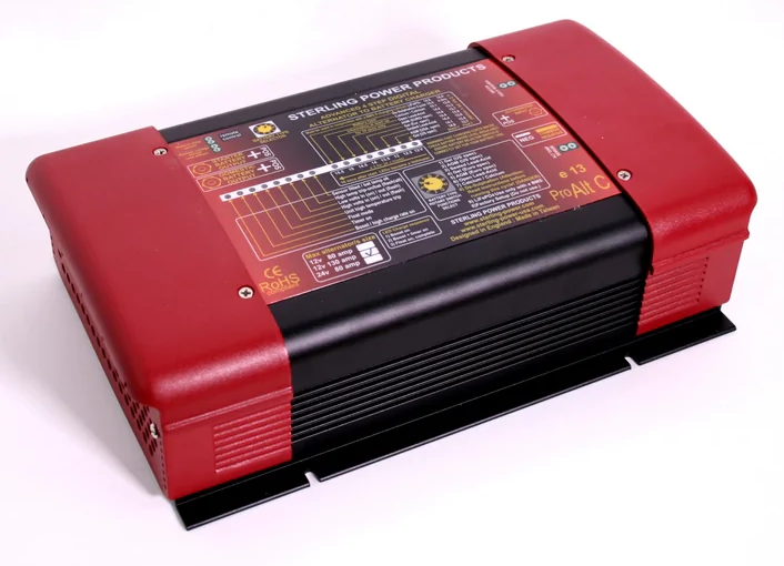

Narrow boats use in the main stage charging when on shore supply, so 14.8 volt until the amps drop to around 4 amp, then drops to 13.8 volt for last 15% of the charge. The alternators use pulse charge and capacitors to store energy between pulses, and the amount of charge is worked out by the decay time of voltage between the pulses, this is for the domestic batteries, the engine start batteries just have 13.8 volt to them shore or engine. It is common to have two 70 amp alternators linked together with a charge controller, which is an inverter which kids the standard alternator to produce more power. 1659340449705.pngThese are expensive bits of kit, even the 80 amp version costs around £350.

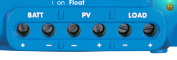

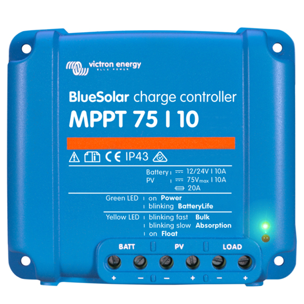

The wind and solar MPPT chargers are similar, 1659340662949.pngthe terminals
separate load from battery so it can monitor the load, the one shown is £76 with a maximum battery current of 10 amp, for a 2.5 kW heater looking at over 200 amp at 12 volt.

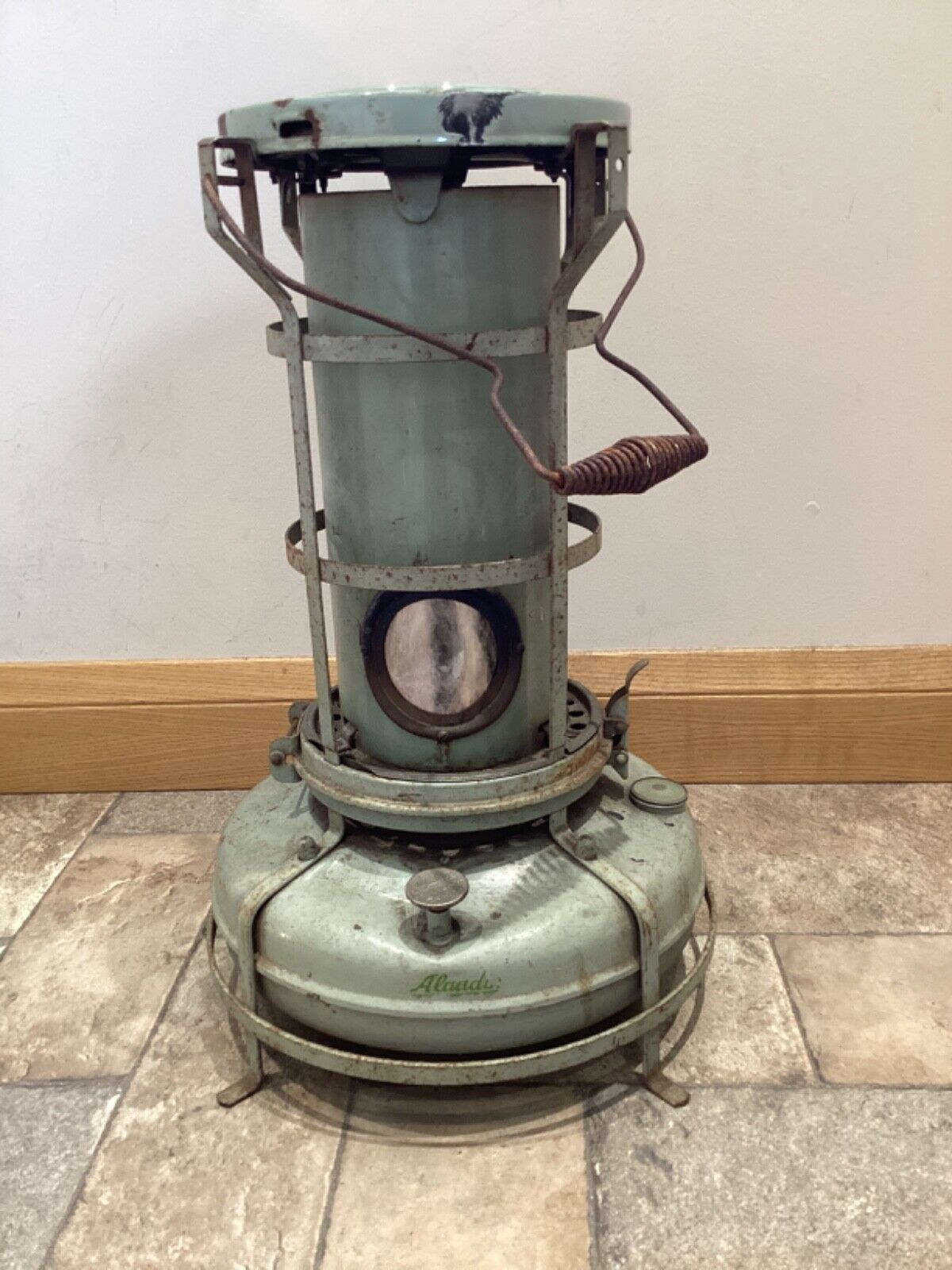

So not really looking at lead acid, and looking at a much larger battery, some thing live the Tesla Power Wall, now your looking as serious money, around £8,600 to £10,500, I am sure they work well, but think some thing like this 1659341415686.png is a better option.
