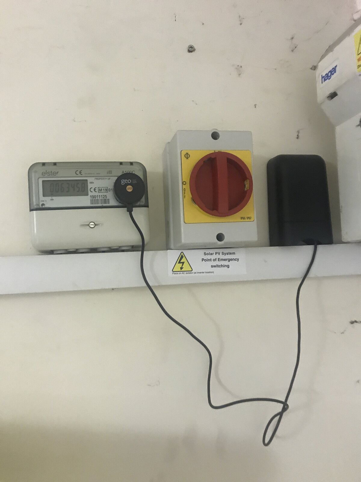

How do i do that? my immersion has an electric switch which we’ve never turned on. I assume we are heating the water via boiler?
how would i use the solar?

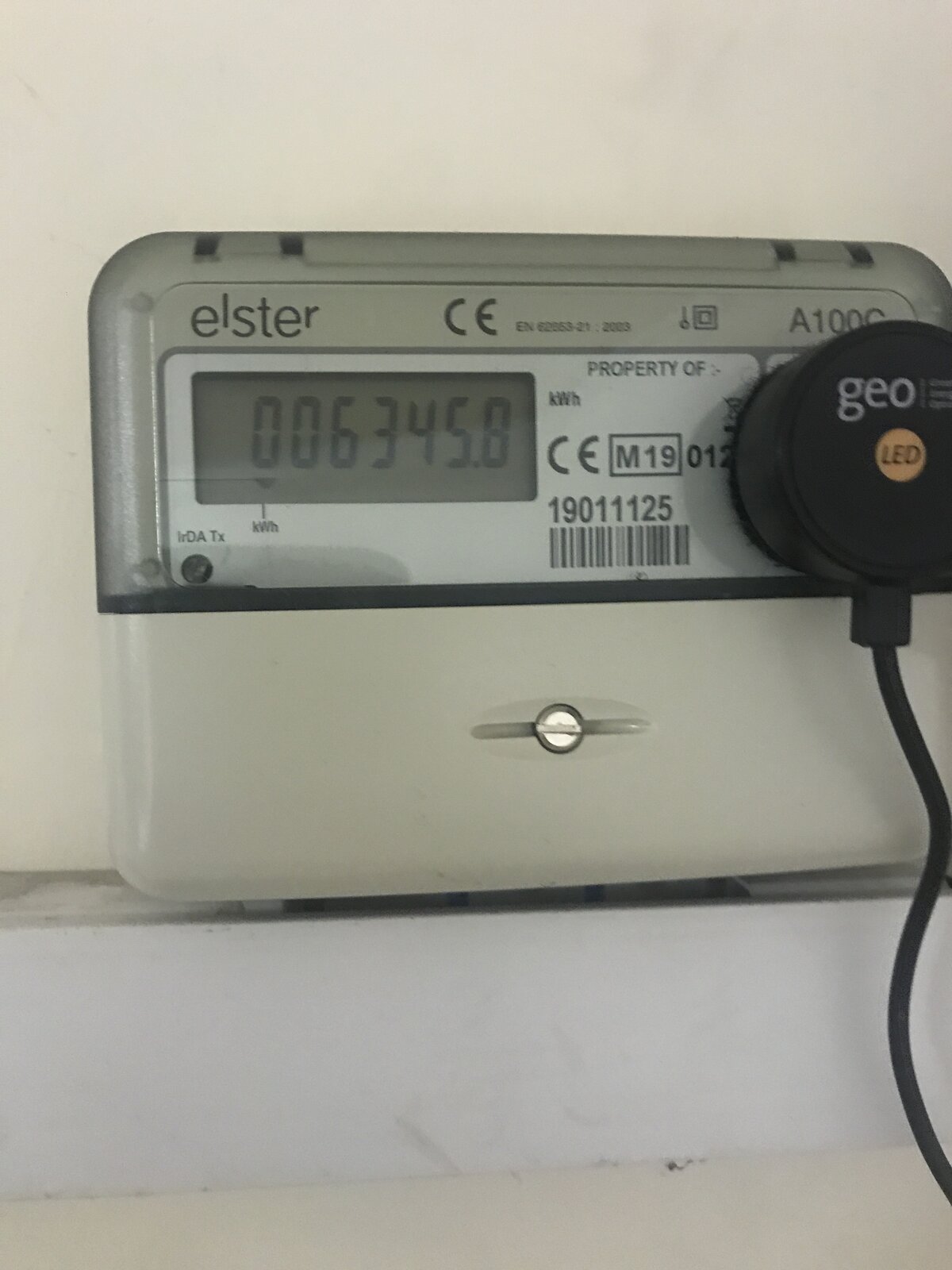

The panels should be wired back to the consumer unit and that electricity should be used. How can this usage of the solar electricity be seen or quantified?
By comparing the generation meter with the import meter, or for a real time display buy a suitable meter with sensors on import and export cables, and you can have an instantaneous net import figure. I use the Wattson, but that is unfortunately no longer available.

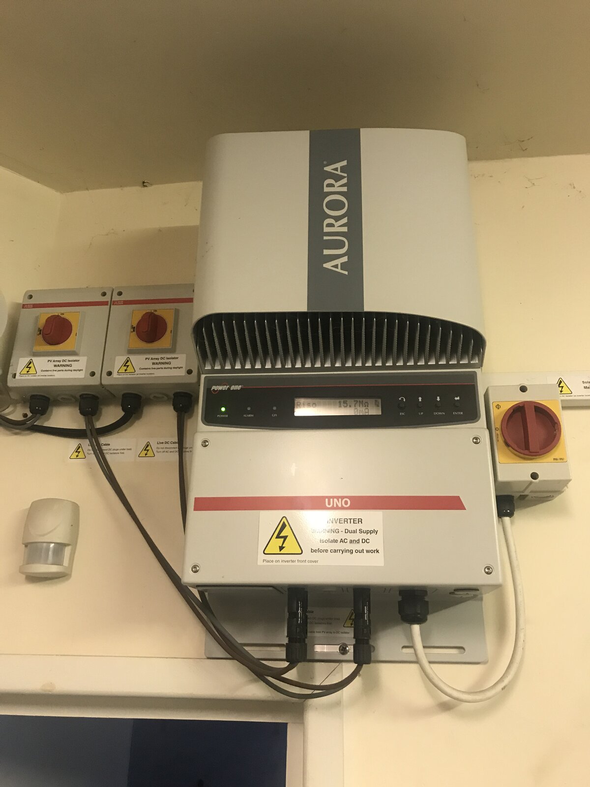

How do i do that? I have small meter which is where i take the fit readings from and the large box. All i know is when i moved into this house my bill went up from £100pm to £140 and now telling me £350pm
its a bigger house but our usage hasnt really changed so £40 rise and im getting some from solar?
C9F0A457-489C-4DC7-866F-11AFC6329E3C.jpeg B5C1FE72-BBF3-4A2D-843F-94356EADAF35.jpegB9D90E95-4851-40C3-A182-D1FF64E9FAD5.jpeg
The meter does have a infra red adapter which had a handset but i didnt see the point of it so unplugged.
One way to do it would be a set like this:
https://shop.openenergymonitor.com/emonpi-energy-monitor-solar-pv-bundle/
which, I admit, is probably a bit nerdy for most, but the principal is the same for all these things - one clamp goes over your main feed and one clamp goes over the inverter output. You need to be able to get the clamp over a single wire in order for it to work:
https://learn.openenergymonitor.org/electricity-monitoring/ct-sensors/installation
I don't know how stender would do that, from that picture it looks like the output of the inverter is a flex with both in.
