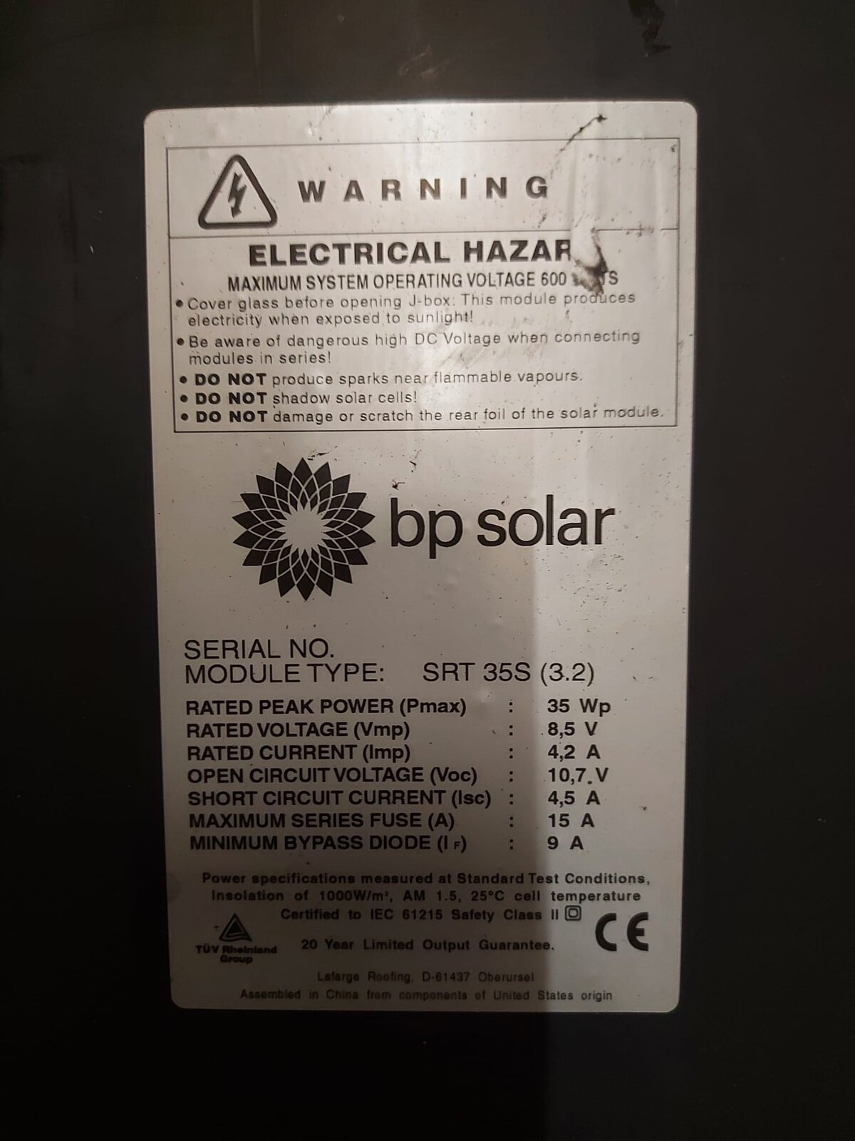

Hi folks, I was wondering if someone would be able to help me make some calculations for numbers of solar panels needed? I've got an opportunity to get my mitts on some due to someone else's upgrade.
I have various numbers and a photograph of the label (attached), and we use ~400 kWh a month, but I've never been confident with numbers and trying to work out a) if they're suitable and b) how many I'd need is making my head swim.
Grateful for any guidance.

Quick maths noting that what John said above is 100% correct and relevent.
The panel you show when operating at 100% efficiency and best daylight conditions will provide 35W(peak) of power (when illuminated by 1,000W of sunlight at 25°C).
Note that new panels are all greater than 250W per panel. Not 35W. These are very old and you need 8 for every 1 new panel.
If it stays on at that 100% efficiency and the sunlight does not dip the panel will provide 35Wh after 1hour.
I guess it will have have less than 50 efficiency as it is old. So maximum provision will be (50% of 35Wh =) 17.5Wh after 1hr in great sunlight
Panel will produce only work when it is light during a day, so let's say that is 8hrs (out of 24hrs),
So maximum power in great sunlight will be (17.5Wh x 8hrs = ) 140Wh in one day in great sunlight.
One panel will then produce (30days x 140Wh ) = 4,200Wh over one month if in great sunlight for 8 hrs every day and with 50% efficiency.
Convert this into kWh by dividing by 1,000 =
one panel will produce 4.2 kWh over one month if in great sunlight for 8 hrs every day and and the panel has 50% efficiency.
You need 400kWh per month, so that means you need
(400kWh / 4.2kWh per panel =) 92 panels.
But as John says, that is not true as the panels will only address the power you need when it is actually daylight (and also when it is sunny).
I used 8hrs of sun in 24hrs above. So if you use your power evenly over a day (which I am sure you do not as most use more at night) then you need
(8hrs/24hrs) X 92panels = 30 of these 35W(peak) panels to address your daytime usage.
This might be about right as I ignored that the sun can go behind clouds etc.
If budgeting, remember that this only saves you a maximum of (8/24 =) 33% of your 400kWh electricity cost, and you will also have to pay for a controller and fitting.

These are 35W panels.
How much money are you thinking on spendiin on these? They might be better option.
And how big is workshop?.
A solar panel mppt solar charge controller matches the voltage through the day, but a pair of panels and a zenor diode can also be used, but output per panel drops.
What voltage are you looking for, they say 8.5 volt so assume looking at 12 volt. What to do depends in the main on cost.
£7 each.
For tiny old panels, that's overpriced.
New can be had for about 45p/watt.
https://www.bimblesolar.com/solar/large-panels/655w-canadian-solar-panels
Those BP things are 20p/watt, but that assumes that they still have 35W output which they won't, and how much life they have left is unknown.
They will also take longer and cost more to install as they will need far more connectors and cabling, and that also means many more possible connections to fail. Generally are to be avoided unless you can get them for a low price, such as £2 per panel.

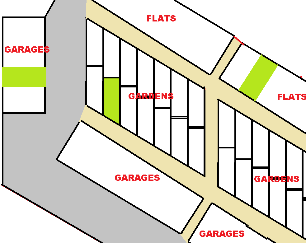

A friend wanted exactly this situation for his home garden office, that's a posh name for a 10ft x 6ft fully insulated/carpeted wooden shed. For a period he used a pair of 12V 85AH leisure batteries to power 2 laptops, wireless hotspot, cordless phone & mobile chargers and 2 lengths of LED tape. Each night the batteries were moved to the garage and connected to LIDL 3.6A smart chargers for between 8-12 hours.
This was supposed to be a very temporary arrangement pending a house move but that came to a halt when lockdown happened.
To put this into perspective they live in a pokey first floor flat with the garden the other side of the walkway and the garage is the other side of another walkway & drive. Something like this in green:
When it was obvious he was not moving he fitted a pair of 29V 275W PV panels in parallel directly across the batteries, on a sunny day he was seeing about 9A but over the course of a week or so it proved to not be enough to keep the batteries sufficiently charged, he fitted 1 more PV and every couple or 3 weeks he would put them on charge for a couple of nights. A bit more frequent in the winter.
He is fully aware a proper management system is likely to be more efficient.

Oh of course it's just occurred to me these are the 'SRT' solar roof tiles. I don't believe these ever really took off due to reliability, I don't know if that's actually correct but I loved the concept and would have installed them if it hadn't been for the high cost (ended up not installing any PV).
