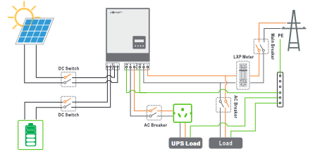

I have solar panels, and battery, and today had a smart meter fitted and while the grid supply was disconnected my central heating was running, so clearly it can run without a grid supply, (Islanding) but as to if battery fully flattened over night whether it would kick back in when the sun comes up, never tried.
The grid tie is designed to power down when grid fails to ensure no back feed, and my supply comes from a special part of the inverter and the 4 sockets and FCU are always powered from the inverter, and there is a system to auto disconnect the TN-C-S earth when the power fails.
So I have some thing like this
a small generator may work, or a second inverter, but it needs to run within the permitted voltage and frequency as it is designed to disconnect if it detects loss of supply.
I simply don't know how accurate the supply would need to be, and clearly it could not export any surplus. You are trying to make the inverter do some thing it was never designed to do.

Off grid is a completely different game to on-grid. In on-grid the grid is responsible for providing a stable mains supply. Your solar and battery just put energy in and out as they wish. The grid deals with all the difficult problems of maintaining a stable voltage/frequency in the face of sudden changes in load. In an off-grid system your battery/inverter needs to do all that work.
In an on-grid system you can just have seperate inverters for your batteries and your panels . It's a bit less efficient but it will work fine and means there are less compatibility concerns. In an off-grid system you really want one combined system with batteries, panels and inverter. There do exist off-grid or backup power inverters that can work in conjunction with grid tie inverters (IIRC the tesla powerwall works this way), but I don't think it's a common feature and it also gives you a bit of a bootstrapping problem.
Afaict off-grid systems also ofteb work at much lower voltages, presumablly because of their history of being derived from marine/travel systems.
The bottom line therefore, is that a pile of donated on-grid solar gear is likely to be of little use for building an off-grid solar system.
They can certainly use the donated panels and batteries, what they need is a charge controller and off-grid inverter (you can get fairly chunky ones, my work place has a 5 kW one in a vehicle and that‘s nowhere near the largest one that manufacturer offers).
