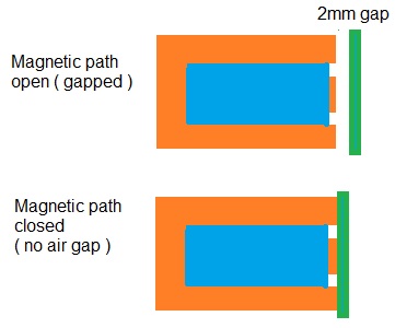

However, returning to context, no-one seems to have responded to my comment that I find it hard to believe that an electromagnet powered only by a thermocouple would be capable of winning in a battle with the force of a fairly substantial 'return spring'. Comments?

Solenoid = a coil of wire wound on a cylindrical bobbin formed from non-magnetic material.
Yoke = a magnetic core that fits inside the bobbin. It can be extended around the solenoid to form a magnetic path
Armature = a movable item formed from magnetic material that is attracted towards the yoke when there is current in the solenoid.
If the magnetic path is closed then the force that resists the separation of armature from yoke is many times greater than the force that attracted the armature to come into physical contact with the yoke for the same current.
Depending on materials and construction the force required to separate armature from yoke can be as much as 50 times the force of attraction across a 2 mm air gap.
Solenoid blue
Yoke orange
armature green
If the magnetic path is closed then the force that resists the separation of armature from yoke is many times greater than the force that attracted the armature to come into physical contact with the yoke for the same current. ... Depending on materials and construction the force required to separate armature from yoke can be as much as 50 times the force of attraction across a 2 mm air gap.
I don't doubt any of that. However, I remain surprised that even "50 times" the (tiny) force of attraction that could be created by a thermocouple-powered electromagnet with a 2mm airgap would be enough to overcome the force of a strong spring - but it sounds as if my intuition may be wrong!
