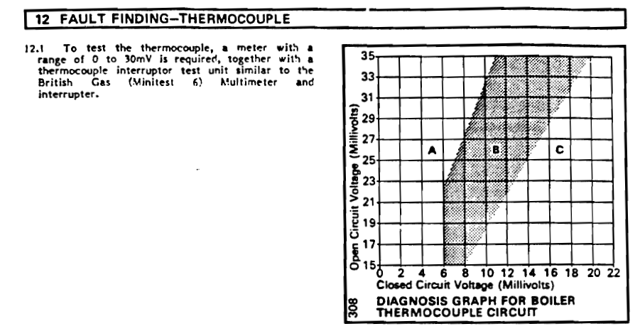

A piece from a 1970's Gloworm boiler manual ......
It compares the open-circuit & closed-circuit voltages. If the intersection falls within the shaded area then the thermocouple is good.
