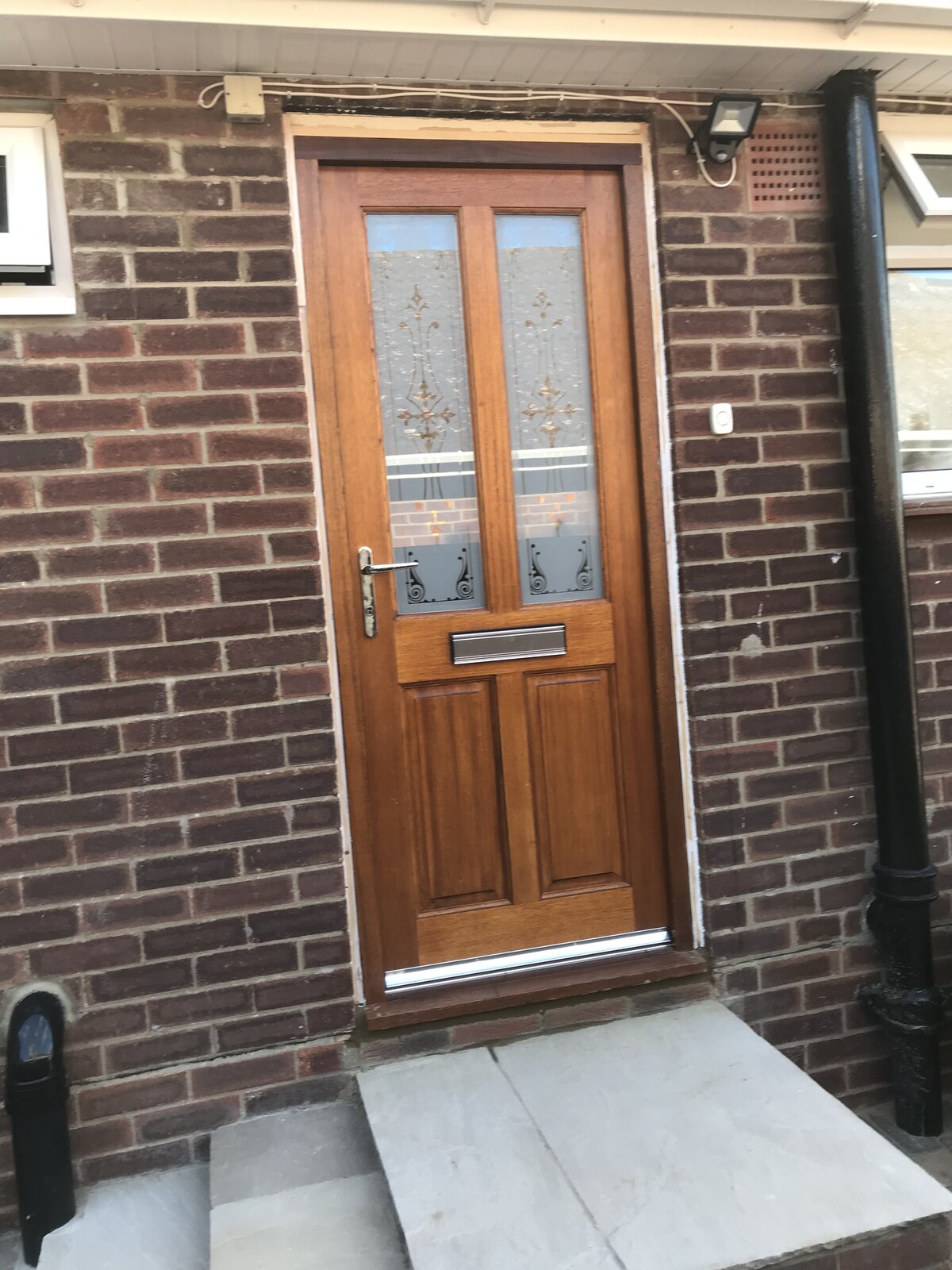

I live in Hampshire and have a west facing wooden front door. Came complete with frame and was fitted by a chippy. It was coated before fitting with an undercoat and two top coats of something like sadolin. I cant remember the exact stuff but it was fitted in July 2020 and could do with a rub down and recoat this year.
Manufacturers advised against fitting west facing but I wanted wood so went ahead anyway. I don't regret it.
