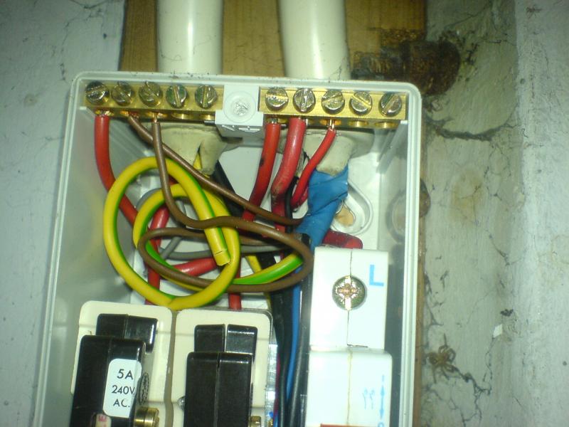

hi all
this is one of my favourites

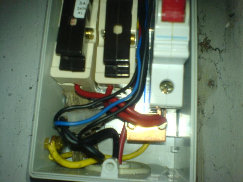

32a mcb-6mm t+e- under floor then along wall into "consumer unit" in garage.
6mm line goes into white mcb/ "isolator" ratings have been rubbed out. From this is a bit of busbar and cable feeding 2 cartridge fuses 1 with 5a fuse 1 with 13a fuse wrong type sqeezed into holders.
These then feed into the "busbars" (former n+e bars) at the top which feed sockets and lighting in the garage. Sockets wired in 1mm t+e lighting wired in 2.5 singles and 2c .75mm flex with earth for fluorescents tapped off skts :rolleyes:
The harmonised wiring was added by a local "spark" a year earlier without comment on the installation to the customer.
Although non complaint and dangerous these are all too common.

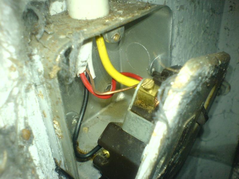

the wire seen comming through the hole were the socket should have been is 1.5mm flex feeding a box with two sockets that were used to charge radios and also continued to crane top and ran the air craft lamps.
No earth rods at generator. No Earth leakage trip. And cable protected by 63A MCB. It was routed across rough land on a building site and not fenced off in any way.
Best was I could not turn it off because of health and safety as in Heathrow Airport and aircraft lamps on cranes were rather important.
It was replaced by 10mm SYY cable and the MCB reduced in size earth rods were non started as generators swapped so often.
