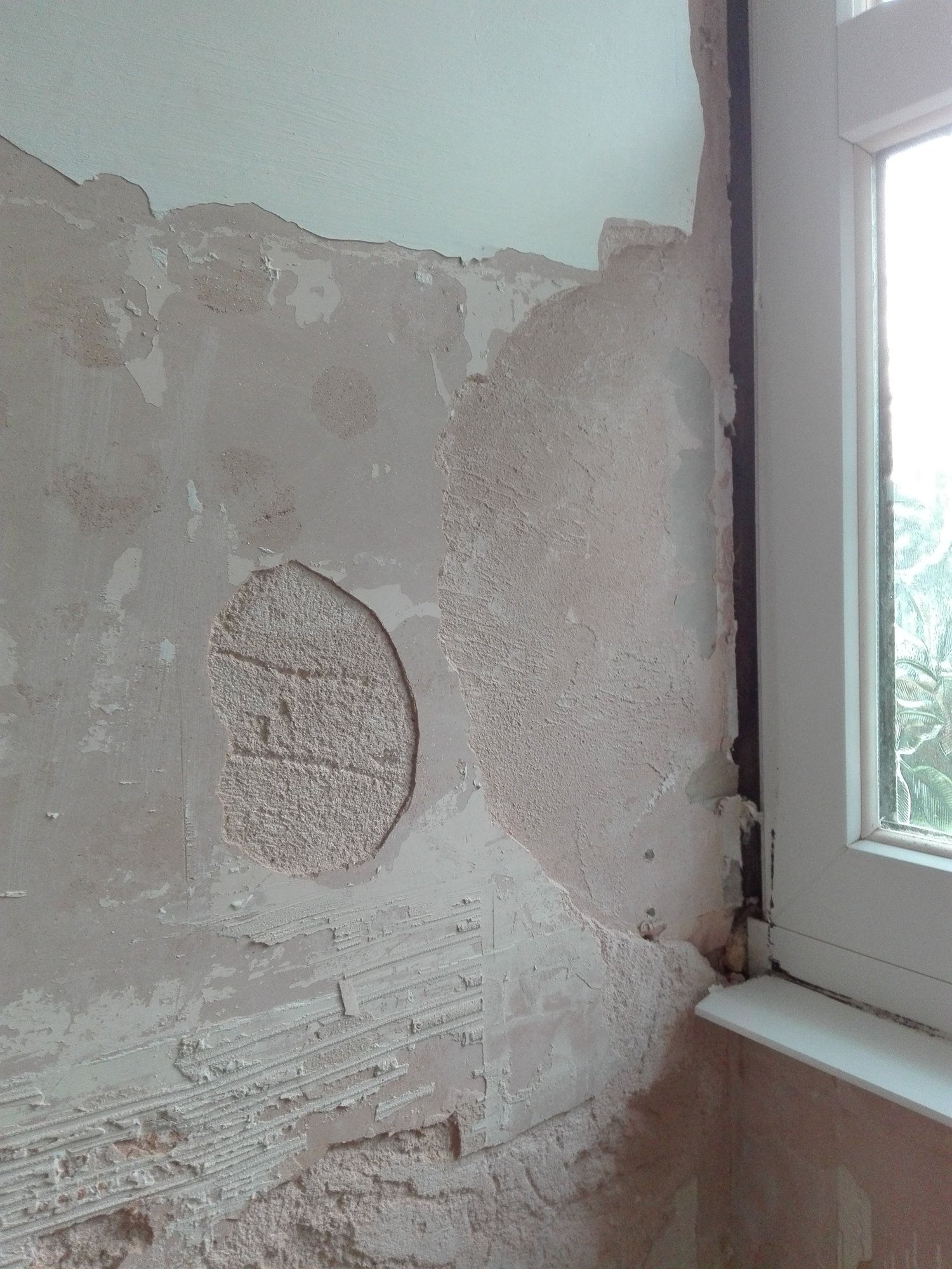

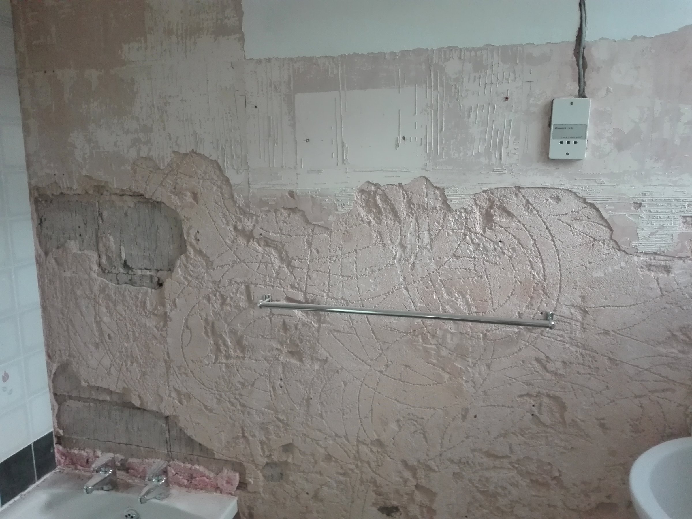

We are redoing the bathroom walls, and have removed the tiles. Some came off really easy (think this bit of wall was painted underneath) others came off ok but pulled the plaster skim off, others were a nightmare and pulled the render off too:
Yes, those black tiles really were stuck down with expanding foam... and others with silicone. Since i'm gong to tile the wall anyway (probably) i thought the best plan was to take the skim off the top half of the wall, then just tile straight onto the render, but the top half of the wall is solid, and the plaster doesnt want to come off easily! So... i thought i'd have a crack at skimming myself, since it wont be visible if i muck it up, but a few questions if i can...
1) I will need to fill the larger holes in the render (whats best for this - sand and cement or bonding? - walls are lightweight blocks)
2) Do i need to pva the render before plastering, or just moisten?
3) Can i skim the bottom half of the wall with one coat, then skim the whole wall with a nother coat, will it crack half way up the wall if i do?

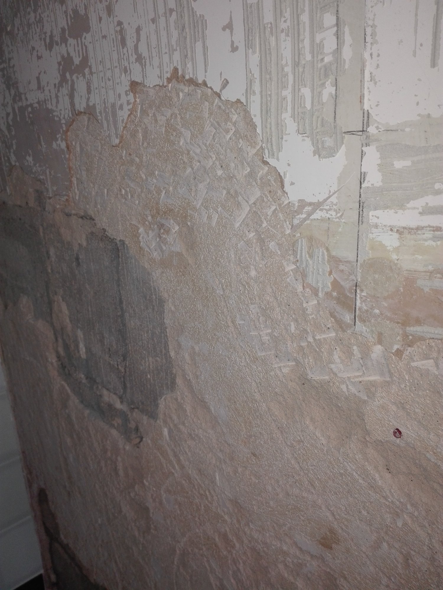

4) There are some deeper holes in the render, but not through to the blocks, will i need to top these up, or will the multifinish fill them ok? Hard to see but there is a pic:
5) In the top right of the wall it is actually a dormer, so plasterboard not block, the render is missing here, what can i use to bring the level up (similar to q 1 i know), can i use cement render or not? picture below:

I would just prime the whole lot with SBR and then just go straight in with tile adhesive
Tyr Thistle one coat plaster. PVA everything first, even the edges on any adjoining walls, and then skim across. The one coat is a bonding and a plaster all in one, and will handle the depths you have there. Chappers suggestion is a good one, but you'll use more adhesive, which is more expensive that the one coat plaster.

It's supposed to be able to be good enough to paint on, but I haven't managed to get that good a finish with it yet, so you'd be better off bonding thae wall, and then using muli finish for that.
PVA is water based, and stops or slows the suction when you do your next coat, and acts as a bit of a glue in certain circumstances. SBR is used where you're going to tile, and you don't want the PVA to become live when you add something wet on top of it.
One coat can be 2" thick, but if the coats are thin and thick all over, then it'll go off at different rates, and be a bit trickier to level smoothly, so best to put on a leveling coat first, then a more even coat afterwards; but if you've got to do that, then you're back to using bonding for the thick/leveling coat, and then multi finish for the top coat.
Ok, think my best bet is to get some bonding then, level the bottom out first (i can also use this to fill the chase in yes - after removing the cable for the shaver point?), then multi over the whole lot.

But you would use bonding to bring up the bottom level to the top half, then apply scrim tape to the join, (not absolutely necessary though) and then skim the whole wall with mutlifinish. You can apply scrim tape to the cracks if you want, but if you don't know what's causing the cracks, then they may well reappear elsewhere.
Ok, sorry, i thought i would only use binding to fill the deep holes... but your saing i would use bonding on the whole bottom half of the wall, which would bring it to the same level as the topcoat plaster on the top half of the wall-which would then give me one level on the whole wall just in two materials?
