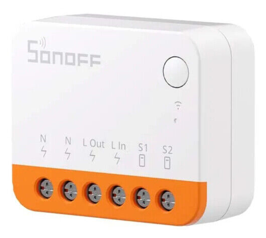

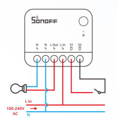

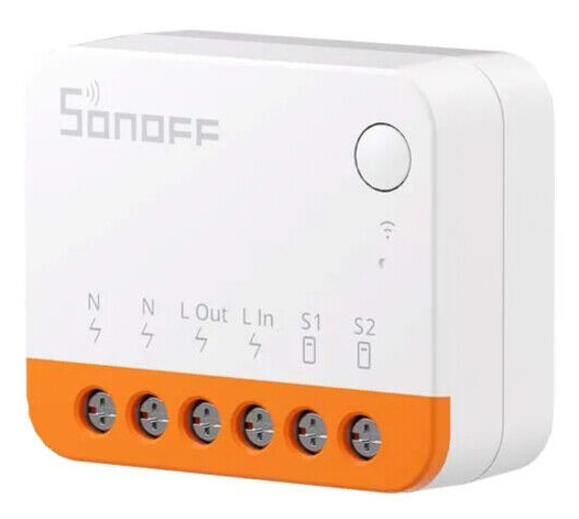

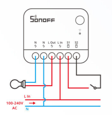

If this 1699174149707.pngis the relay you are talking about then the contacts are not volt free, so you can't have a dimmer before it, with a standard ceiling rose in the UK the standard way to wire is to use the ceiling rose as a junction box, if your house is wired this way, then you can use the existing switch wires and have a simple on/off switch wired to S1 and S2 so it does not matter if the lamp is on or off the switch will charge state. So switch then works like a two way switch with the wifi controls.
Or you can take the L out to the switch and then have the return go to the lights, this means the dimmer will over ride the switch and the dimmer will work and there is no way to turn on lights with app if dimmer is off, and no way lights on with dimmer if the app is off.
If the switch is used as a junction box rather than ceiling rose, then it depends on the design of the switch, with some the dimmer and switch can be used independently, if this is the case then maybe you can wire it differently, but picture of back of dimmer switch or link to spec for dimmer switch will be required to work it out, and one would need a large back box to house it all, plastic of course radio waves will not go through metal.

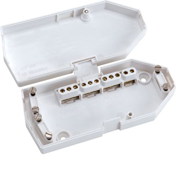

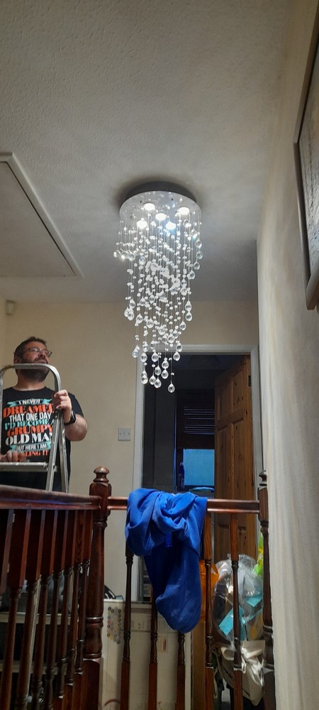

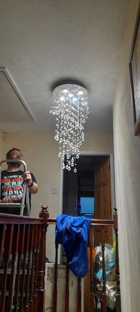

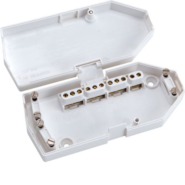

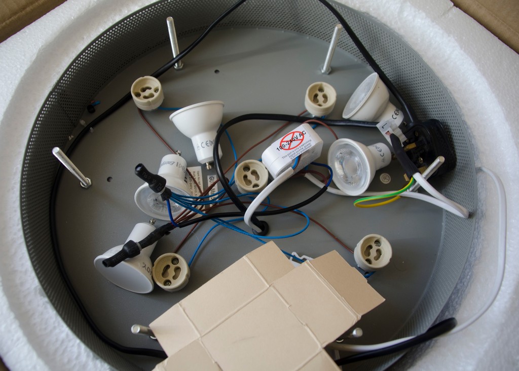

The instructions are clear enough 1699177873840.pngthe S1 and S2 terminals are normally extra low voltage so no mains connection to your switch. In your ceiling likely some junction box like this 1699178135332.png the Sonoff relay will need to go in an enclosure near to this, a surface mounted back box screwed to beams with a blanking plate or similar, in my case the down lights were in a large enclosure DSC_6062_1.jpg so did not need a junction box for the smart relay, 20220529_211956.jpgDSC_6799.jpg and I used the two way switching version of wiring. It makes it so much easier with pictures, we are guessing what you have, the ceiling rose is often the junction box and it is often replaced with the lighting junction box shown 1699178135332.pngbut some people do use maintenance free boxes, or simple back box and blanking plate and some strip connectors inside it.
If originally fitted with down lights often the switch back box is used as a junction box, this can be a problem with getting the room to fit the relay, we are guessing at what you have, and a picture can replace a 1000 words.

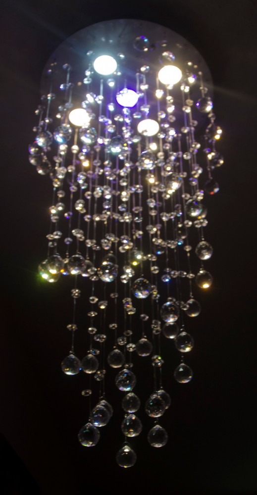

Mine work with Google Nest Mini's and hey google turn on landing lights works well, I used a twin contact relay so centre lamp can be independently controlled from the outer four and the centre one is colour changing bulb so have these effects Centre_bulb_colours.jpg using just centre bulb. I avoid using the first one as not living in a red light district.
