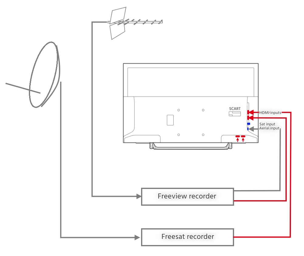

I have a Bush Freesat recorder connected to the Sony at the moment.
I would like to be able to connect a Freeview separate recorder also.
I find the user manual a bit "jargonish" on how to do this!

You need a working UHF TV aerial for Freeview. The TV has an aerial input so could be used to check one works. If not you need one installed.
Your TV is able to record onto an attached USB hard disk drive. That may allow an extra TV channel to record when there's a clash affecting the freesat box? (Except that with You View enabled on the TV that feature appears to be disabled, according to Sony's footnote).
A Freeview Play recorder (the latest incarnation of the spec, replacing You View) will connect to the UHF TV aerial and have a hdmi cable connected to the TV in the same way as the Goodmans freesat box... The TV is listed as having four hdmi inputs... unless you are using a really old freesat box with SCART cables? In which case it may be time to upgrade that box?
Older Freeview recorders will also work in the same manner.

No, because the Freeview recorder only records from the internal tuner supplied by the aerial input. There is no feature to record from a SCART socket or any other AV socket.
If you want to record from a video level source then you want a DVD recorder or DVD/Hard-drive recorder with a Line In feature.
If you can't or don't want to install an aerial then loan your Freeview recorder to a friend with a working aerial feed and get them to record it for you. Once the box is back connected to your TV then you'll be able to play it back. You don't need an aerial connected for playback, only for reception.

Your TV is HD capable. SCART is SD only. Many PVRs nowadays don't have scart outputs anyway.

The present Freesat box is connected via an HDMI socket, I will read the manual first in future!
Presuming you get a HD-capable Freeview recorder, then your hook up is simple.
The Freesat recorder is already connected. You said so in your opening post.
The Freeview recorder requires the TV aerial cable moving from the TV to the RF IN on the recorder box. I'd recommend adding a fly lead from the recorder box RF OUT to the TV RF IN. This way you'll still be able to watch Freeview on the Sony independently of the Freeview recorder being in standby or recording two or more channels.
You'll also hook up a HDMI cable from the Freeview recorder to one of the unused HDMI inputs on the TV.
That's all you need unless - for some bizarre reason - you decide to use a non-HD Freeview recorder with only a SCART connection.
