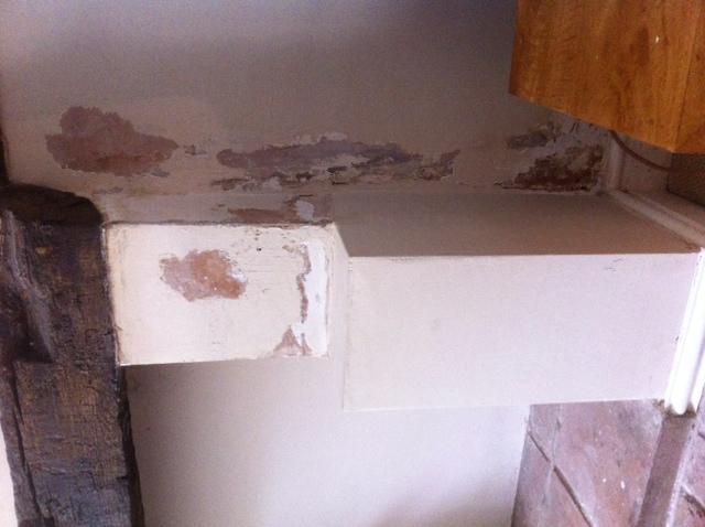

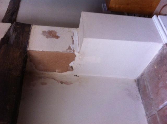

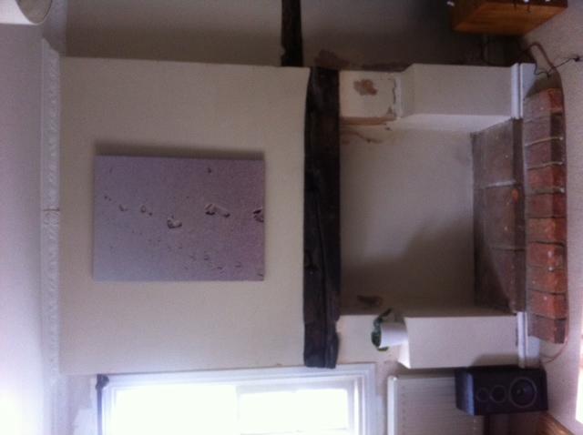

Sorry, but I have searched high and low around the forums and I can't find any reference to my particular issue.
Basically We have a disused chimney in the sitting room on the ground floor, the chimney breast in the floor above has been removed and it looks to me as though the chimney has just been boarded up at 1st floor floor level. There are large damp patches either side of the chimney, spreading round onto the outside wall, however the outside wall inside the chimney and the front of the chimney breast itself is dry.
I removed the obviously 'blown' plaster around the really damp patches to reveal visibly wet cement / render. After a few days the cement has already started to dry, and is now more or less dry to the touch - I don't know if this is relevant, but it might be a pointer to a solution.
Would it be worth my while putting a vent near the top of the remaining chimney venting either into the room (would keep the heat in, but allow air to circulate??) or out of the external wall (chillier I should imagine??). Or should I just get the whole thing damp coursed?
The damp seems to manifest itself around the entrance to the cavity, rather than coming up from below, but this may be a false lead...
Any sane suggestions gratefully received.
Please excuse sideways photos...
