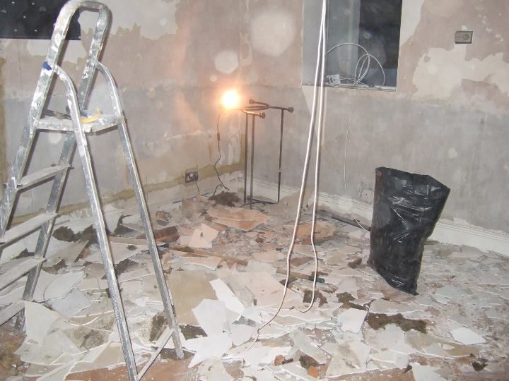

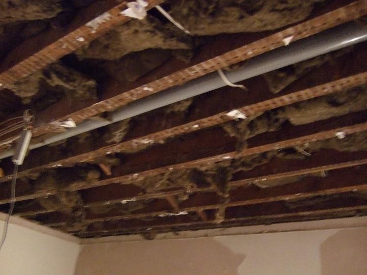

Celing down, nice filthy job
Pathetic previous insulation (remember this is between two flats....

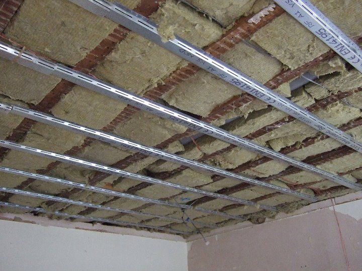

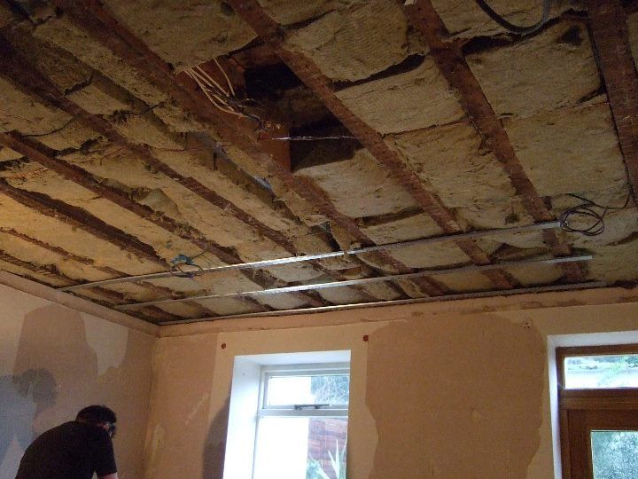

Rockwool going in....
Res bars up....

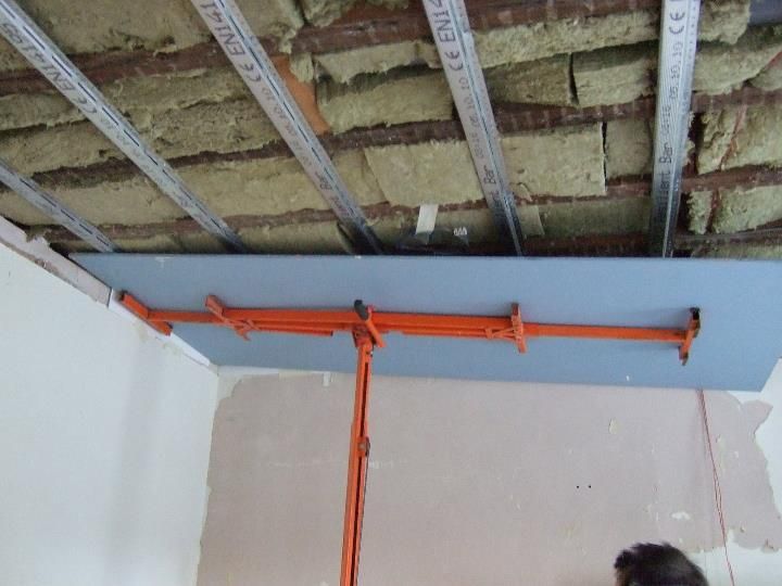

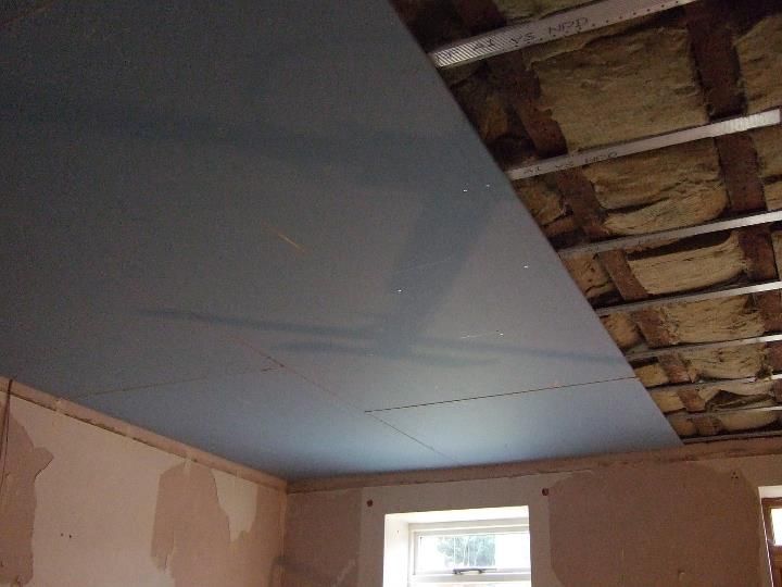

1st board of 1st layer going up. You will need a hoist as the boards are 45kg each.

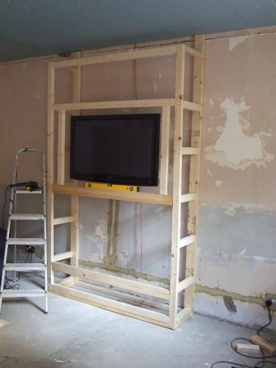

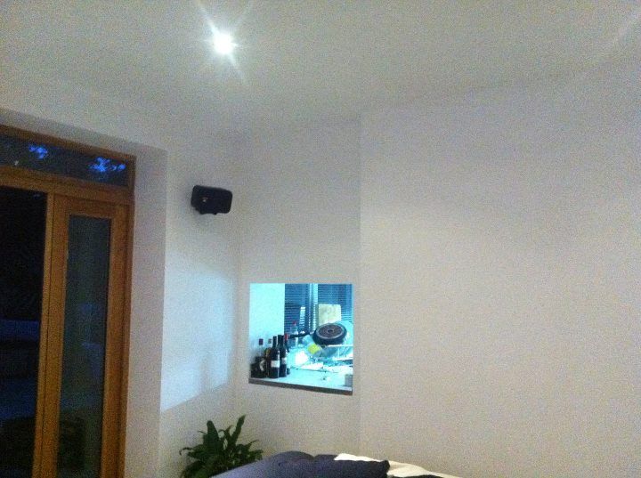

False chimney for TV

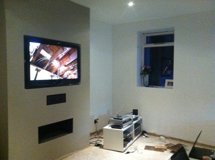

Plasetered and painted
