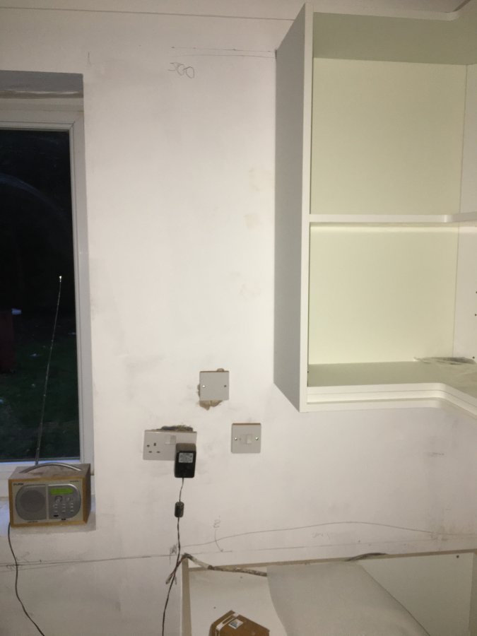

Our clumsy sparky put a blank plate where a kitchen wall unit is meant to go . He has to move it. Any suggestions. Could I move it where clipboard is meant to go and put a hole where backer board is meant to go. I need a quick, reasonable fix
Trying to understand that. But, if it is something to do with anything, you need to be able to access it. You also need to be able to access it if there is a screwed junction inside!
I suggest that you have a square hole cut in the back of the cupboard and fit one of these
https://www.tlc-direct.co.uk/Products/MTMDLB1.html
Bring the wires into the box and fit a blank plate, switch,. or whatever should be there.
Regardless of kitchen design, that's the wrong place to put a plate?
It is only wrong because whoever has designed the kitchen, decided to put a wall unit where a switch plate was.

Is it me, or is something on the p*** in the photo, either the cupboard or the window reveal?
That's certainly how it looks, but photos can easily 'lie' in situations like that.
In any event, it's a problem that I've often come across in my house - in which very little is square, straight, flat, horizontal or vertical. If the window (or just the window reveal) is not vertical (and one doesn't want to rectify that), then one thing or another is almost inevitably going to end up looking wrong, no matter what one does!

I wonder why the socket, blank plate and FCU are not all in one straight line? It would look better that way. A dual box for the FCU and the blank plate would be neat, in the photo it does not look as if the socket and the FCU are exactly level.

Ah, making more sense now - it was a light switch.
I guess if an electrician was present he should have made sure where the cupboards were going and be aware if any electrical accessories would be in the wrong place - then again I don't know what was expected of him. I can only imagine the blank plate/light switch was there before a cupboard was decided to go there.
Either way, the cables should go upwards, meaning there should be enough length in the cables to re-position higher up into the cupboard.
