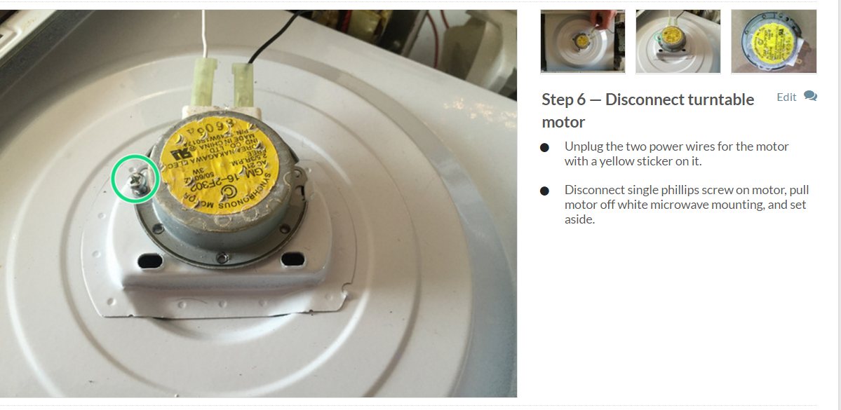

I'm hoping to get my hands on a Microwave turntable motor very soon, and I'd like to adapt it for the BBQ.

OK, I must admit I have no idea what the underside of a microwave looks like.
Edit, I just found this:
Well, it seems like that motor is internally geared to produce 2.5 to 3 RPM so therefore it can be connected directly....however, can I see a marking that says 12v AC :eek: ?
If that's the case it'll need its power supply module too.
To protect it from heat it'll have to be remote from the rotisserie so a drive shaft of some description will be needed.....maybe a flexible one.
John :)
The motor that I'm planning on using is from a micro/convection/grill type of combination oven so can I expect it to have some in-built protection against heat?
Granted, it's mounted at the bottom of the turntable, but I would plan on mounting it t'other side of the brickwork from the BBQ.
Combination ovens are well lagged against heat transfer.....as that one seems to be direct drive then its better to deal with the heat than most.

I haven't got the motor yet, that is to say, it's still being used. But because the platter has broken in half, and I can't find a suitable replacement I might have to replace the microwave. So, as yet, I don't know the spec' of the motor.

Might well be too weak to turn a spit given the weight and torque involved. The microwave turntable runs smoothly on wheels , very little power being needed.
my thoughts exactly you will need somthing about 5 to ten time the power unless your spit ends are on roller bearings and the spit is completely balanced
if your not balance then you need the power to lift the extra weight beyond the 9/3 oclock position
