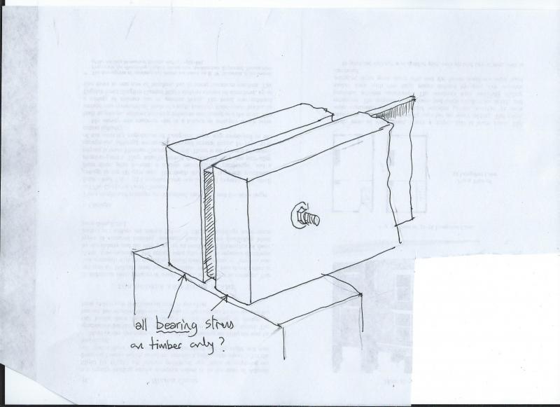

Actually Ronny, I think you were right first time. You said 'bearing stress' and if the steel is shallower than the timber, the timber will take all the bearing force. And that force is of course transferred from steel to timber via the bolts.
Or were you perhaps absent-mindedly intending to say bending stress?
Erm...steel takes the bending and shear stresses, timber takes the bearing stresses.
So, where the steel is designed to take the full load:
The bending stresses are all taken by the steel...
The shear stresses are transferred from the steel to the timber at the bearings through the bolts...
And likewise, the bearing stresses are transferred from the timber to the steel through the bolts...
So that means Catlad was right, doesn't it?
Or maybe it works both ways :?

Re the bearing stress on the spliced beam;
FWIW, this is may take on the position;
If the steel plate is shallower (top-to-bottom) than the timber beams, then surely only the timber is in contact with the padstone, so logically all the bearing stress must be on the timber?
So the timber takes all the bearing stresses - at both the supports and along its length from whatever it is supporting.
All of these bearing stresses along the beam's length are transferred as a shear force through the bolts to the steel.
The steel then resists bending along its length, and shear at its end.
The shear force is then transferred through the bolts as a shear force into the timber, which then transfers the load to the bearing in the form of a bearing stress. Right?
