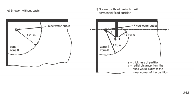

I imagine that "a wet floor" refers to a situation in which the entire floor is effectively a giant shower tray - such that everything in the room (below 2.25m above FFL) is in Zone 1 ?

I guess so. The good book focuses on bath rooms that have wet areas that have their own boundaries.
I’m sure there are lots of wet rooms out there with electrical devices that don’t meet the zonal and IP requirements.
I guess so. The good book focuses on bath rooms that have wet areas that have their own boundaries. ... I’m sure there are lots of wet rooms out there with electrical devices that don’t meet the zonal and IP requirements.
Indeed and I'm not sure I've ever really thought about this before. However, as you say, if the entire floor of a wet room is effectively a giant 'shower tray', then I strongly suspect that you may be right that there are plenty of 'non-compliances' out there!

@EFLImpudence ... That helps a bit, but seemingly only if the (only) 'water outlet' is fixed.
My cousin has a sort-of 'wet room' (certainly no shower tray/'basin') but which, although it does have a 'fixed water outlet' (which I would guess is about 300mm from the 'end wall'), also has a hose (which I guess is at least 1,000 mm long) - so 'common sense'/consistency might suggest that the 'extended Zone 1' probably ought to extend to roughly 1.2m beyond the furthest the shower head (on the hose) could be from the wall - so perhaps 2.2m in total?
Kind Regards, John

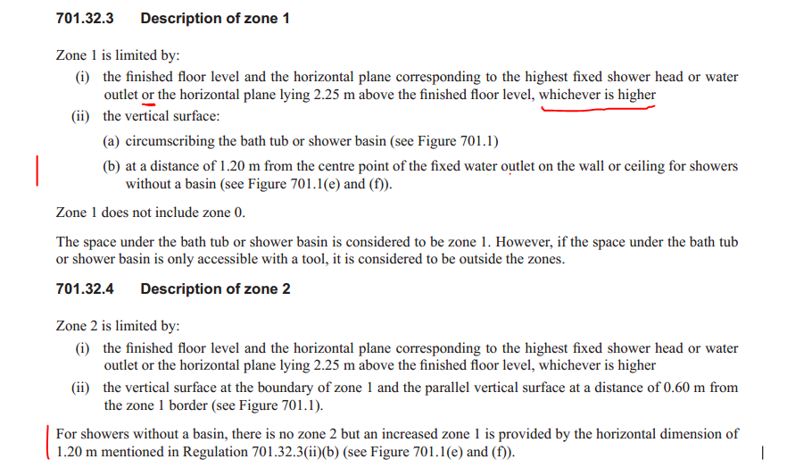

As I understand it, in the absence of a tray/basin, rather than saying that Zone 1 then becomes the entire area of room's floor (which is what I originally assumed), there is a 'dispensation' that allows Zone 1 to be restricted to 1.2m "from where the water comes out" (if that is a fixed place). As I said, when there is a hose "where the water comes out" is the downstream end of the hose - so, "for logical consistency", Zone 1 would extend to 1.2m from there (hence probably about 2.2m from the origin of the hose).
Rather than saying Zone 1 is 'restricted', it is extended to 1.2m (from fixed head), in effect, taking over what would be zone 2.
Thus the stricter Zone 1 conditions apply.

The regulation only mentions and applies to 'fixed heads' which a hose is not.
If there were a shower tray which was 2m x 2m, or 3m x 3m (i.e. occupying most of the room, so much the same as a 'wet room') then everything above it would presumably be Zone 1 (regardless of the nature of the water outlet') - so, in comparison with that, it is a 'restriction' (or 'dispensation').
Exactly. As far as I can see, there is absolutely nothing in BS7671 which defines Zone 1 when there is no tray/basin BUT a hose (rather than, or as well as, a 'fixed outlet'). I therefore don't know how one can decide the extent of Zone 1 in that situation other than by 'extrapolating' from what they say of the situation in which there is a 'fixed water outlet' ...
