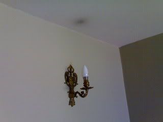

Spotlights leaving black marks on ceiling
I guess it is doing something like this:
And this is normal. It doesn't matter what type of lamp you have, if it creates heat it will cause convection current to transport airborne dust upwards.
As has been mentioned, some types of stain will reappear after painting with water-based paints, notably tobacco and soot.

It's taken me a long time to get back to this, I know, but thanks for all your responses. It looks like the best thing is probably to replace the spotlights with LED ones. Until I get round to that I think I'll just line up the spotlights with the strip. That way any soot should end up on the strip and will be relatively easy to remove.
An ioniser might be a way of dealing with it, it should attract a lot of the dust in a room to the dark corner it is situated in (of course the downside is that you have a very dusty corner to clean every now and again!)
