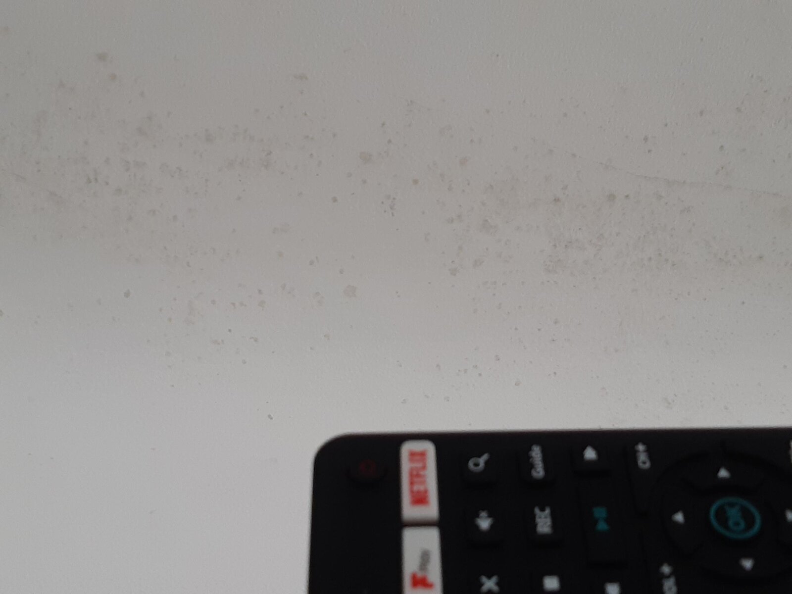

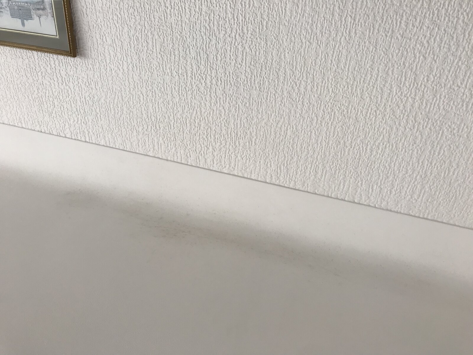

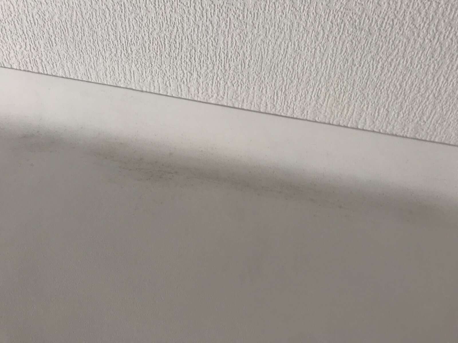

There are spots appearing around the top of the living room wall (outside wall) and ceiling edge, its a bungalow.
I use a dehumidifier regularly but this is not making any difference.
I've added some pictures, one shown with a remote control next to the spots so as you can get an idea of the size of the spots. For the last couple of years these have also appeared in the bathroom (joined to the other side of the living room) and the bedroom (joined to the other side of the bathroom). All along where the outside wall is.
I presume these are condensation spots but I'm asking on here as I have tried everything possible by the book and not had any joy. The loft area on that side has been checked and everything appears dry as I was wondering if this could be something maybe coming in along the roof edge.
Any ideas of how to solve this would be greatly appreciated. Hope I have attached correctly.

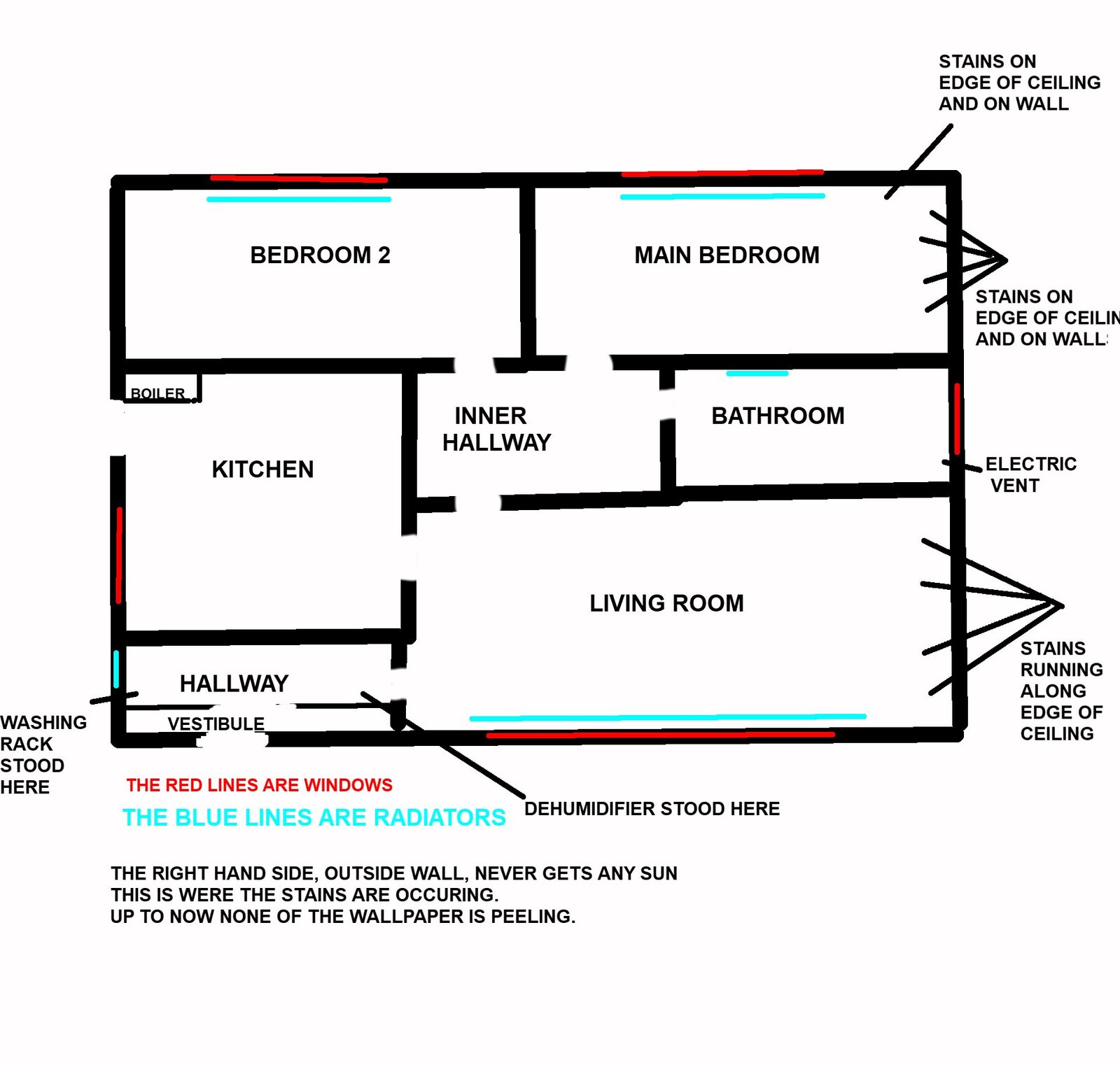

My real BIG worry is if this is damp. If you all think it’s condensation then I feel I could try further to rectify by having another electric vent fitted in the bedroom and in the living room (other side of the bathroom). I’ll do a diagram.

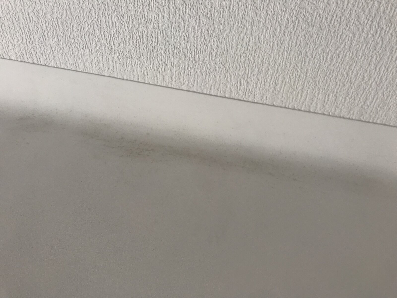

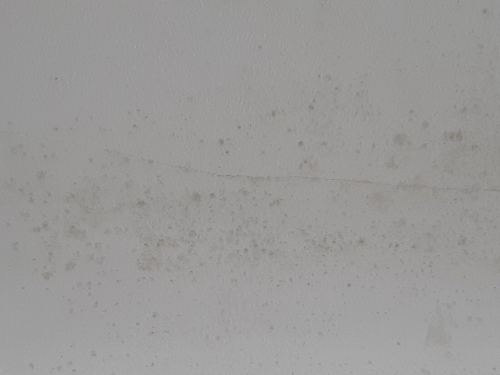

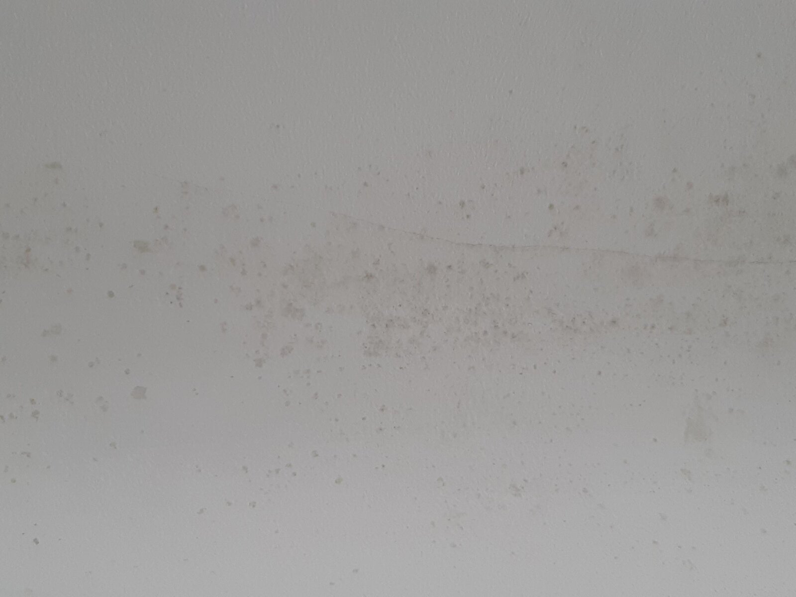

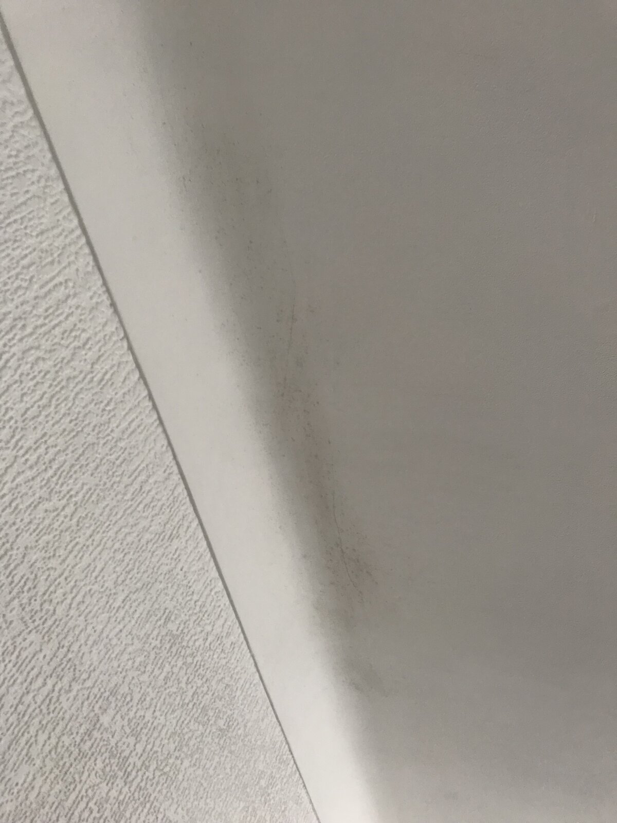

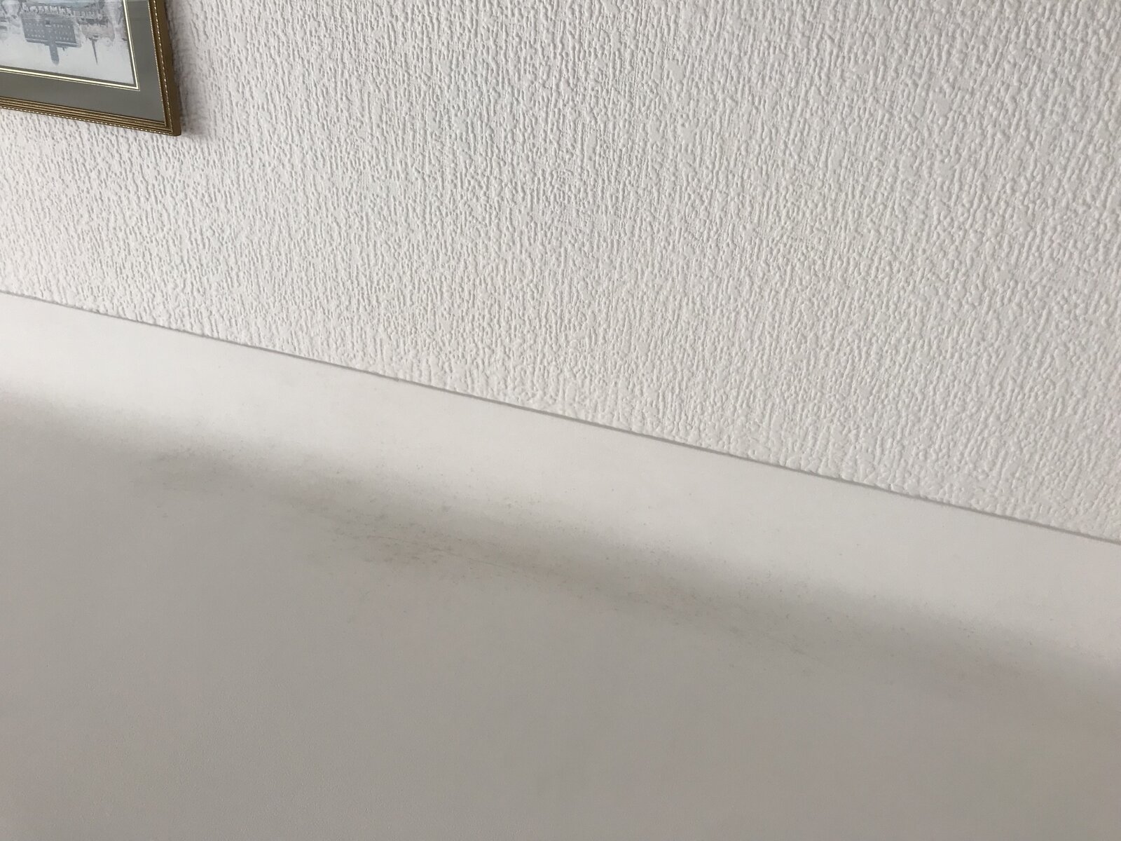

Here are some more pictures of my bungalow, excuse the diagram.
The photos are showing the living room, wall to ceiling.
I've not taken any of the bedroom walls as it was really hard getting the marks to show but its roughly the same principle.
I think it's condensation; when a house surface falls to about 12 degrees it's liable to start dehumidifying the air and collecting condensation. Solutions are to make the house air less humid, or keep the place warmer. Don't perform activities like drying on an airer, insulate so surfaces are warmer, run the heating, ensure a flow of fresh air. Some of these things you may not want to do, especially rubbing hearing and letting your paid for heat disappear out the window; there are technologies that can recover a percentage of it but they also come with a cost. DIY MVHR is possible, and MVHR is the gold standard for indoor air quality, but again, something you pay for.. If the focus is on saving money, insulate (a one off cost) and dry your clothes on a line outside
HG mould spray is great for removing the mould you have already
A massive thank you for the HG mould spray, bought some this morning, it’s a foam spray.
The bedroom is painted, silk paint, anagypta, the faint stains all over the wall (outside wall).
I sprayed the foam all over and spread lightly with a clean damp cloth, left for 30 mins, and then used a wet cloth to remove. I couldn’t believe the difference, wish I’d taken a before and after picture to post on here.
The ceiling is really not too bad so I only dabbed on the odd spot.
I tried on the living ceilin, very lightly, this also helped, BUT, the HG site says not use on ceilings as they say plaster on ceilings is not as a good a bond as you get on walls.
Any suggestions for the plastered ceiling?
if the wall I sprayed today drys as good tomorrow as it looked earlier then I won’t redecorate just yet, I’ll see how it goes. In fact it was looking like it had been freshly painted.

Plenty off insulation above at that spot? Stops board getting cold
Rather than spraying the ceiling, consider spraying into a cup and using a paintbrush to dot it onto mould spots. It both kills the mould and bleaches clear any staining..
Note that it's not intended to be a solution; it resolves symptoms rather than curing the cause...
For that you need to look at moisture generation, heating, ventilation and insulation
