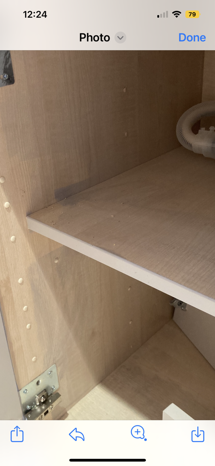

Hi - I have recently had a spray painter into a property to help renovate my existing kitchen. The carcasses were fine, we bought new doors and he resprayed both.
He did not respray the inside of the cabinets, and unfortunately they’ve been left like this.
The carcasses are vinyl wrapped. I have a decorator at the property who has tried to remove this residue using their own cleaning fluids with no success.
I’m obviously really annoyed at this state of affairs, but in practical terms, what can be done? Any ideas gratefully received. Thanks

Just paint them, a bonder first say zin, paint with a roller and seal with a good hard varnish.
Or looking at the photo a light sand and seal.

Thanks for your replies. It’s a holiday let, unfortunately, and the rest of the property is pretty ‘posh’ so I can’t leave it like this. I could probably live with the cupboards under the sink, but it’s in every cupboard including eye level ones where the crockery is stored

No he wasn’t paid to spray inside. He has sprayed the edges and failed to mask the inside of the cupboards, so there is very unsightly spray paint inside the cupboards that makes them look dirty
Have you tried Xylene thinners that brings most paints off without damaging base. But wear protective gloves & mask when using.

ask him what he sprayed them with
it was probably either pre cat, AC or PU
AC / PU can be tricky to get off -but a bit of overspray should come off with a bit of thinners and some elbow grease -bear in mind you cant go too mad or you will start to destroy the melamine surface and it will lose its patterning

You could try T cut or cutting compound think its G5 or 3 or something. Its overspray and not likely to be noticed by anyone on holiday unless they are being supercritical.
