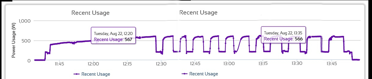

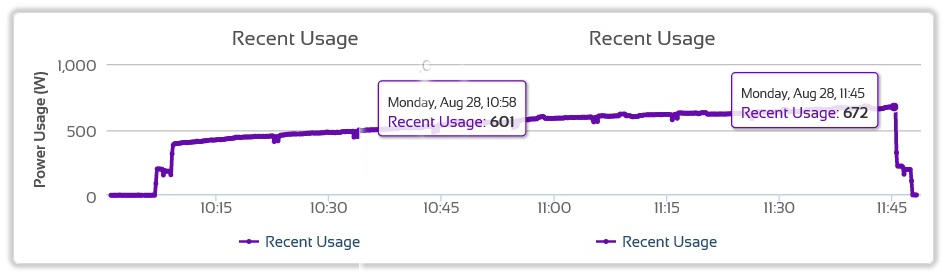

I have been measuring the power used my my dryer, it peaks at around 700 watt, it is variable and depending on load and cycle it can start to cycle on/off, the washing machine only heats water at start of cycle, so the two together assuming using a heat pump dryer will not exceed 3 kW by much and even then not for long.
However there are a load of old washing machines and tumble driers which use a lot more, I used an energy meter
so I know what mine uses, but without monitoring it is like saying I am driving Lands end to that John place can I do it on one tank of petrol.

This is another Tuesday 1 all small load.jpg the average use at the end of drying cycle is right down, I have found it takes a lot longer to dry than wash, so can wait until it has started to do the mark/space ratio before setting off another wash.
