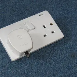

Hmm better makes and the plug. This was one of the many MK sockets I replaced in one year, must have been 15 years ago:
This particular pair were fitted during the Easter holiday in a school, sort of coffee shop/tuck shop place and the device connected being an urn which ran all day. Before September start we were unable to do PAT as the plug could not be withdrawn from the socket.
I`m not sure if I think that MK is "one of the better makes" these days in that it once upon a time might have been one of them. My perception (others might disagree) is that MK at least since the 70s has run more on it`s previous good name since that time and also in the last few years has become far worse still. In fact in the late 70s, 80s and 90s and later, quite a few trade professionals on hearing someone mention MK have made a comment such as - expensive crap!
PS - one innovation, back in the day, was the perception that their flex terminals on plugtops and FCUs was a great thing - Caged washer screwhead in a threaded pillar for you to wind the flex around, whilst I agree that it was an improvement on some that went before I still preferred a round hole for the flex with a dome point end screw on the decent makes. (Again, others might disagree).
