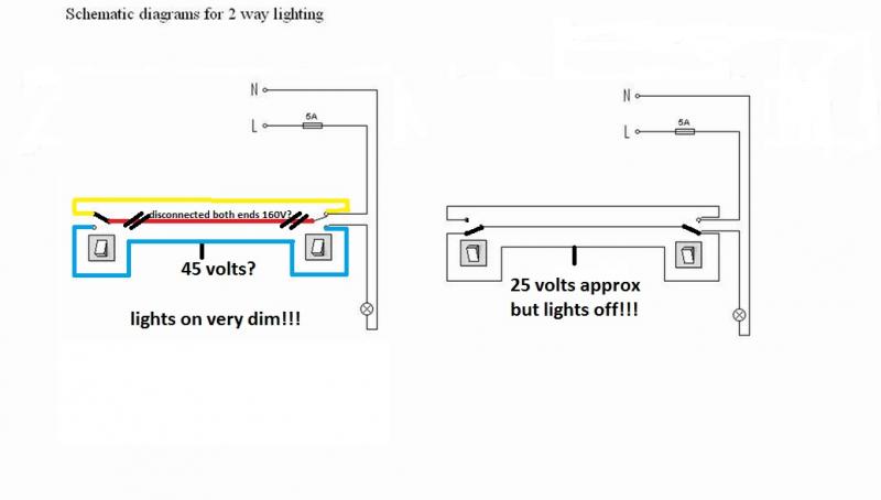

Hi all, ive seen this topic come up from doing a google search on other forums but thought id ask for help on here!! the voltage is not induced from multimeter, I will say that now :)
Purchased some LED gu10 bulbs and they remain on extremely dim when both switches in on position! replaced both switches and fault still there!
had both ends of common disconnected and had 160 volts present???
when all back together and with lights uncommanded 'on', there is 45 volts on blue wire when should 0 volts.
concentrating only on the 45 volts on blue wire, I replaced the wire with a jumper lead and lights work as advertised in every configuration so there is def some line to line but doing futher con checks, there were no line to lines, all were meg ohms to eachother?
find attached 2 pics to illustrate..... there was 20/25 volts floating when lights were off but that seems common because other light was that!
Help much appreciated! if not answer is clearly leave in config where lights are actually off in off position i suppose!! dont like excepting that though!
one last point to add, i took light fitting off and one of the neutrals was giving me 207 volts the other 245 volts, measured to the live Terminal block!

NO the insulation is, if you were getting high megohm resistance values, perfectly OK
Any two conductive items close to each other have have capacitive coupling between them. Changing the voltage on one item will induce a change of voltage on the other. The closer they are the more "coupling" or capacitance there is between them. Materials like PVC even though insulation can increase the capacitance ( this is the dialectric effect ).
The amount of energy that is coupled is very small but is enough to "glow" an LED lamp and appear as a voltage on digital meter. On a moving coil meter the voltage will appear to be far lower as the meter uses some of the energy to move the needle.

If you put 230volts AC onto one side of any capacitor there will be 230 volts on the other side of the capacitor if nothing is connected to it. The reason you are reading 160 or 43 volts and not 230 is because the impedance through the capacitor and the resistance of the meter form a voltage divider.
