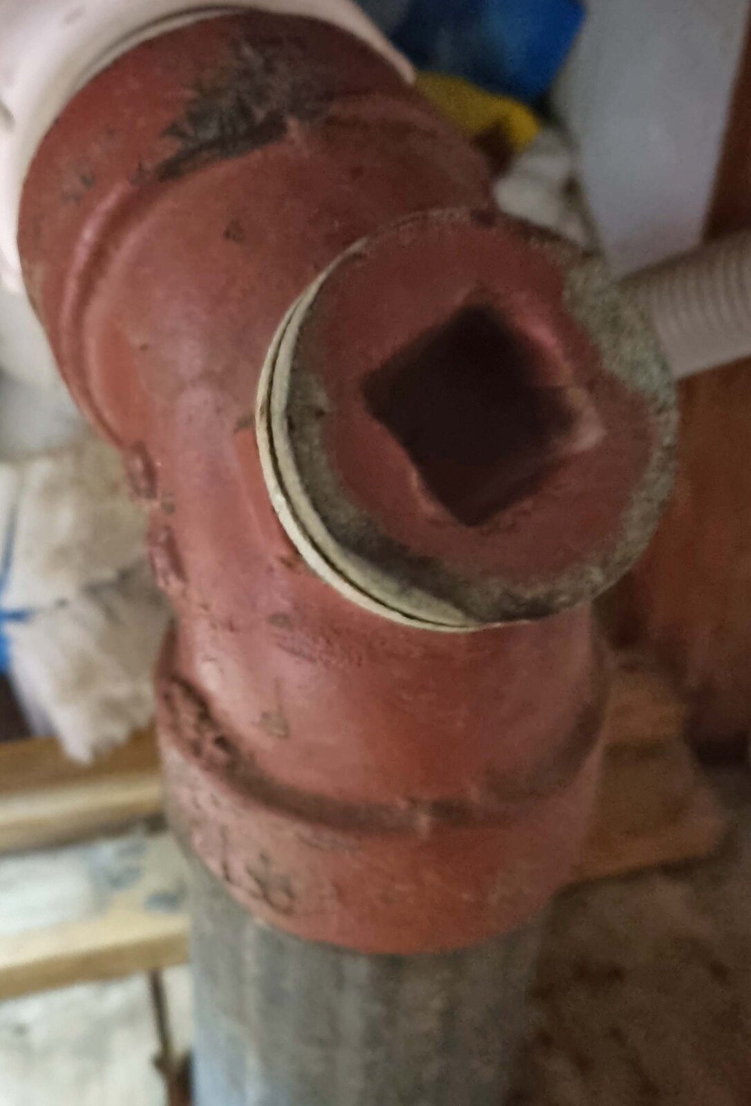

Below is a photo of a brass Access Bend in a 50 mm (2 ") Waste Pipe - under a sink - which must be about 65 years old!
While I have been able to removed this Plug - using a wrench - I know that there is/was what might be called a Square Spanner for unscrewing the Access Plug.
The hole in this Plug for such a Spanner is 19 mm square.
1. What is the name for such a spanner
and
2. where can one be obtained?
I have posed the question of obtaining one in as many was that I can think of on the WWW
but have not been able to find the item concerned.
(The diameter of the threaded part of the plug is 30 mm and I have found it difficult to purchase a replacement washer - but, that is another story.
They seem to be available [in this country] only as Automotive supplies, in packs of relatively large numbers.)
I doubt it will be metric if it's 65 years old. More likely 3/4”. Just get a 1/2” to 3/4” drive adaptor and use a standard 1/2” ratchet. (y)
Thank you (and HERTS P&D).
I own only a 3/8" ratchet wrench.
Hence, two adaptors would appear to be necessary.
One 3/8" Female to 1/2" Male
plus
one 1/2" Female to 3/4" Male.
I am now on the track of obtaining these.
Thanks again.

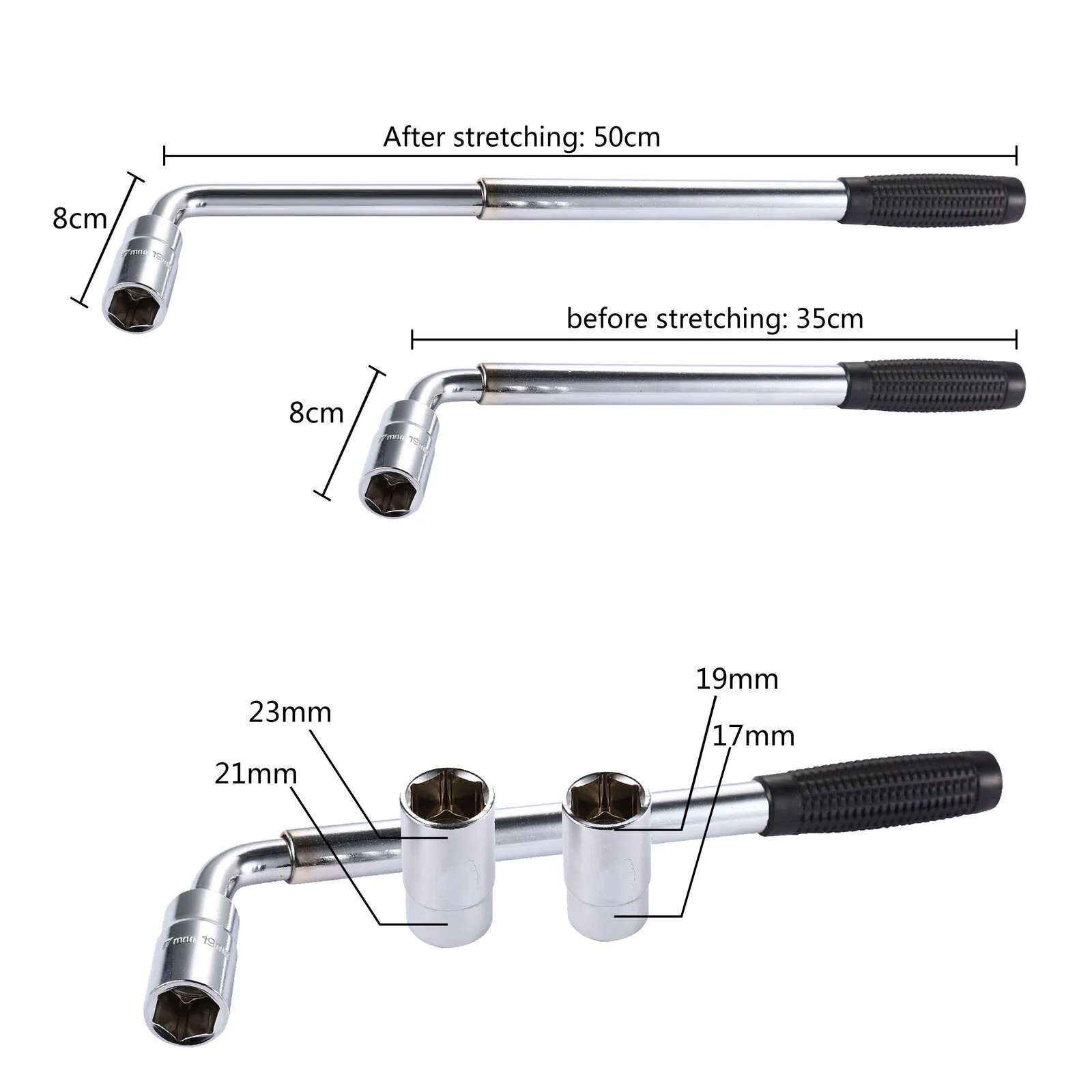

If you have a car, you could consider a half-inch telescopic handle, sold as a wheel brace replacement with a couple of sockets. I think around £7
I got one for each of the family cars, will deal with tight nuts even if you are more Olive than Popeye
