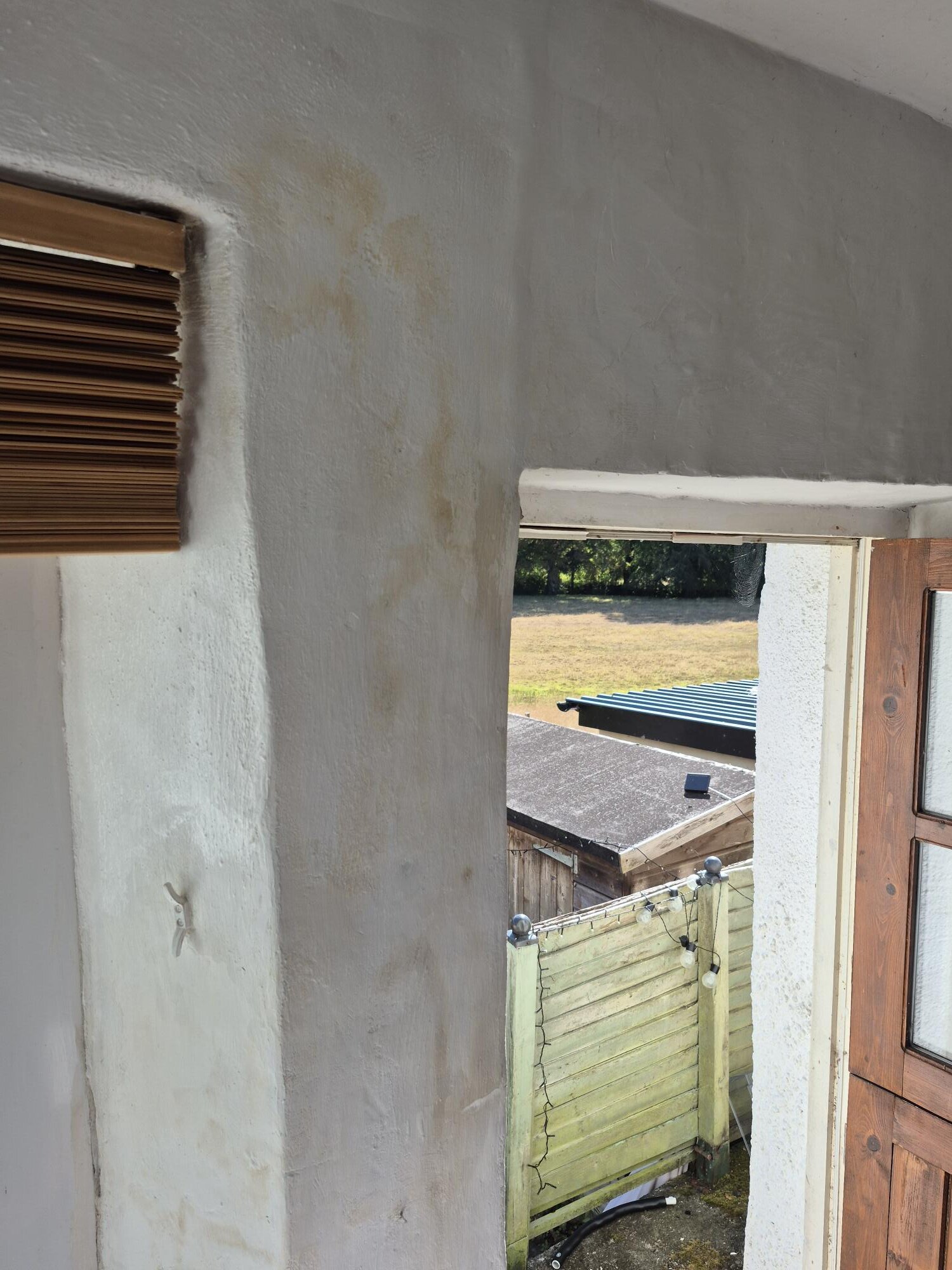

Hi all,
This is a cob wall. A leaking gutter outside has caused damp to seep into the wall. Over the summer the wall has been drying out nicely (and the gutter is now fixed!). The surface of the wall was very powder/chalky. I scraped it all off. I then used white silicate paint. The stains are showing through, so I put on another really thick coat, but the stains are coming through again, almost immediatly.
I dont want to put a coat of stain blocker on becuase I need the wall to breathe.
What is the stain? Why does it keep reappearing? And how do I prevent it from showing again?
Coverstain is breathable..
Take 4 days to cure before you paint over
Personally I always give damp patch stains a coat of gloss paint and then emulsion over the gloss once it's dried.
I would leave the wall to thoroughly dry out before doing anything to it.
Thick walls like that will need a good amount of time to dry out if the exterior has been sorted out.
Thanks guys. So its just the damp stains coming through?
The cause of the damp (leaking gutter) was fixed in Feb 2026. Id hoped - what with all the heatwaves - the wall would be fully dry by now. Perhaps - as you say - it may take another 6+ months to dry completely.
I could use Coverstain to cover the worst of the staining, although it doesnt look to be breathable(?) so Im slightly reticent about using it.
I'm wrong then.
I was always told don't let coverstain get wet because water can penetrate it.
You have to seal it, I'd say. The whole wall won't suffocate if you only seal where the stain is.
You can always scrape some off in a couple of years.
I've used oil based undercoat.
Don't use ordinary pva, it goes rough when it gets damp.
