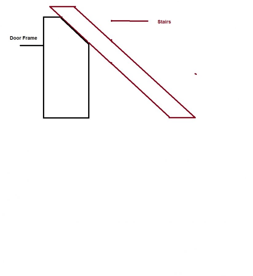

Another question I have is..
Door frames that are not complete..
Please see picture.
How much can one loose assuming its a standard door?
so just to confirm I can have my door at 30" wide and 2100 tall, but have a it angled.

Just limited head height from where I want to start the stairs.
How limited? You are only looking at a saving of 60cm over the width of the winder box, less in reality once you've divided it all out. You may be able to get some dispensation. What's the minimum head height over your existing staircase.
