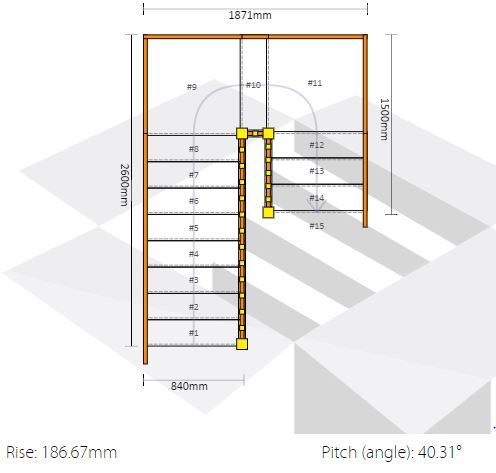

Is there an ideal staircase pitch?
I understand they should be 42 deg max but is 40 deg or 38 deg better?
This is for the main staircase in a domestic house, plan is for 2x quarter landings and a width of 880mm. The 42 deg would fit better, but I don't want a compromised hall/stairs if it can be avoided.
So options are say:
8-Q-1-Q-3 = 14 (x200mm) = 42.0 deg
8-Q-1-Q-4 = 15 (x187mm) = 40.3 deg
9-Q-1-Q-3 = 16 (x200mm) = 38.5 deg
Thanks.

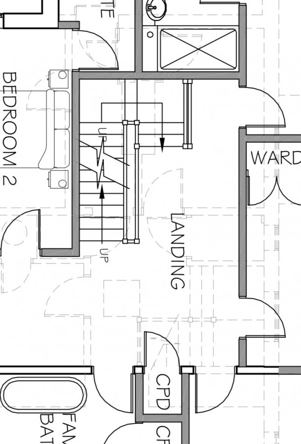

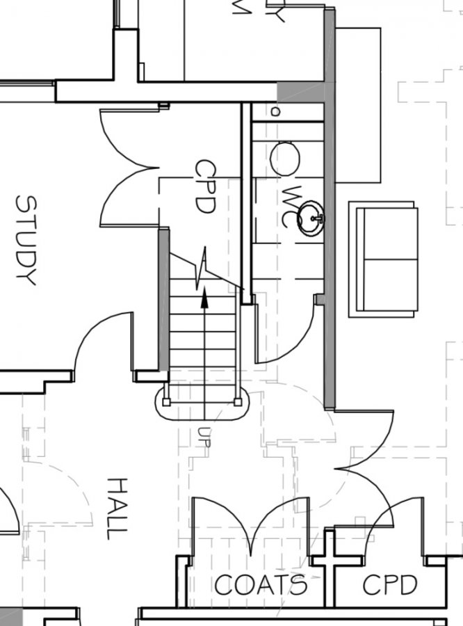

I am trying to lose the bottom 2 steps projecting into the hall, but am constrained by a WC under the stairs.
Drawn as 16 steps, hoping to get 14/15 to work. But will be steeper.
(I can't push stairs back due to 1st floor layout).

If you want to keep the landings, put the two steps you need on the top flight instead. This eats into the head height of your WC, but there is space to move the WC into the hall a bit more (it only needs to move two goings worth to get back to the current situation) and you can always create a storage cupboard (from the extra space moving the WC gives) in the adjacent room behind the sofa, or if it's a main lounge, a cupboard for av equipment perhaps..
My concern with a winder from the GF hall is that it will make the stairs feel less 'grand'.
I want to avoid stairs projecting past the wall into the GF hall; I think this is best achieved by:
1. 15 risers at 187 @40deg (instead of 16 at 175 @42deg).
2. Lose 2 projecting steps at bottom, add 1 at top
3. Floor-ceiling height in WC (i.e. under 2nd Qtr landing) reduced from 2275 (13 @ 175) to 2055 (11 @ 187). **
4. Pull WC forward 1 step.
** This is still >door height and will affect about half the WC.

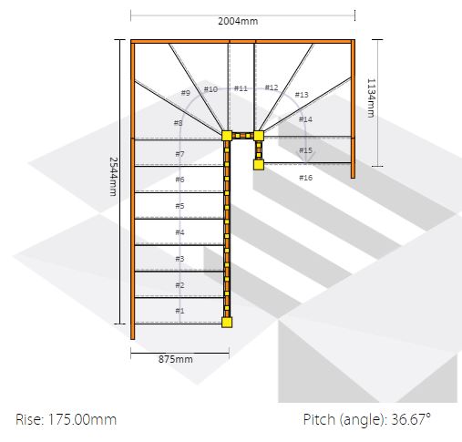

Here are the stairs configured as:
i. 16-step Winder with a 37deg pitch
ii. 15-step Quarter with a 40deg pitch
Both seem to do the job, so it comes down to pitch v type (Quarters over Winder).
