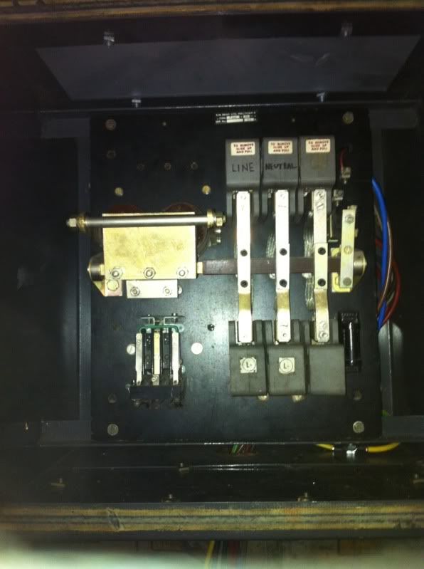

It's some lights in the auditorium of a theatre. The feed comes in from the mains as usual at 240V AC, and then goes through a dimmer and feeds the top of a change-over contactor. The contactor coil is fed from this supply before it goes thru the dimmer.
Then there is a 240V DC supply from a large bank of batteries in the cellar. This feeds through a DP merlin gerin MCB straight on to the bottom of the change-over contactor.
The middle of the contactor then feeds out to a 4 way merlin gerin fuseboard, which feeds a 24 gang MK grid switch, and this feeds out to the various lighting points around the theatre.
The setup is around 60 years old at a guess, The merlin board and the grid switch appear to about 10 years old, and look to be direct replacements for original parts.
It's possibly the most elaborate emergency lighting system I've ever seen, but it actually works incredibly well :D
The load is about 30A total.
Here's the contactor:

In terms of switches you should be OK. 230/240v AC-RMS is equivalent to 230/240 DC. It's the arcing that will get them. That's where the suppression caps can help.
