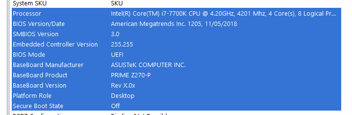

That Z270-P motherboard does NOT have Wifi built in, but that card linked to earlier will add it.

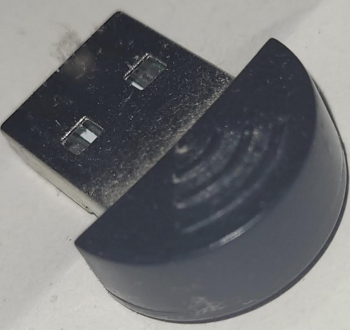

I have one, how would I find it, I don't see it in control panel but I don't know what I'm looking for,
There must be different types, mine is tiny.
So what's the difference between tiny, bigger dongle, and card with antennae, apart from range?
Range mainly, possibly speed if it's a USB2 version.
