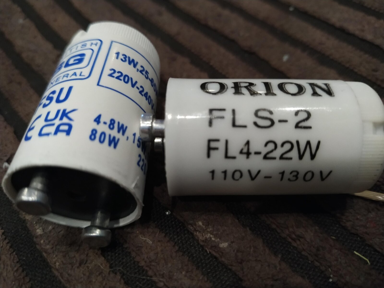

I'm trying to find a replacement for the one on the right. The one on the left didn't work, can someone please help?
I had it years ago, the universal starter would not work, down I think to two tubes on same starter, we had a contract with RS and they sourced the replacement, but the one you have says 110 volt?
A series starter for fluorescent tubes which can be used either with a single tube on a 110-130 Volt power supply or two tubes in series on a 220-240 Volt power supply.
