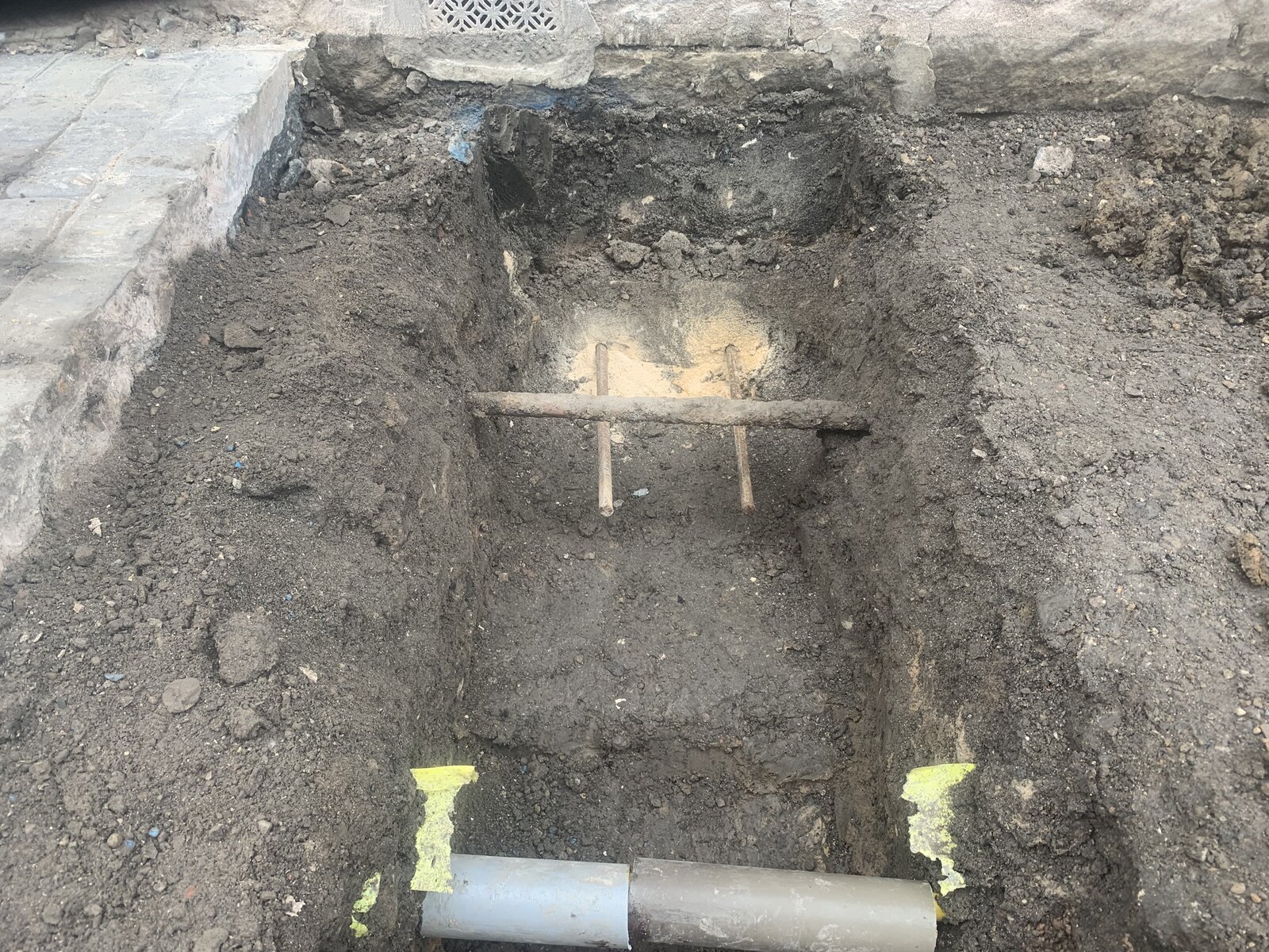

Another question if I may.
Inspector has been out, and asked for rods/bars to be drilled into existing foundations and left protruding, to be encased in the new pour.
Is this standard practice, as it was a new one on me?
He said it was ok to resin in... was thinking drilling 200mm deep (400mm total bar length)

I've been asked to underpin existing (shallower foundations), in particular if there is a point load (steel beam etc) being fitted above, later on.

Been asked to do this alot lately even when the foundation was 400mm below ground level and a slab of 150 year old sandstone.
just take a photo of it to pacify them if they ever ask about it…..which I doubt they will.
