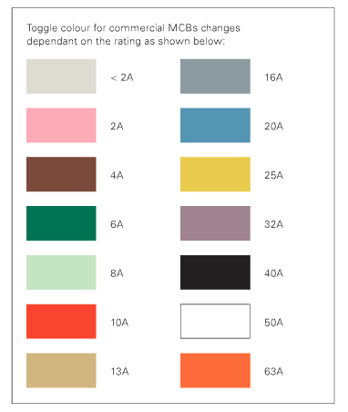

Some people still do use colour coding. I know Eaton and Contactum do
I miss the colour coding myself - white 5/6a, blue 15/16a yellow 20a red 30/32a and green 45a was the traditional colour scheme - I wish that it was made compulsory to have coloured levers on breakers in amendment three!![]()
