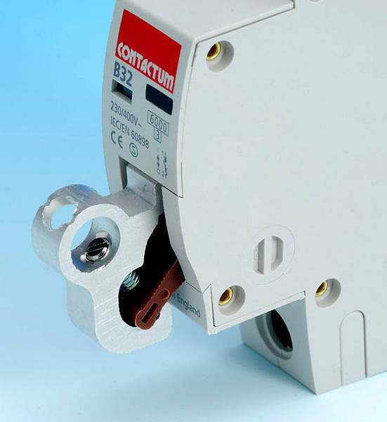

The inspector after reading the Pembrokeshire case needs to list faults, it is a watch my back exercise, very hard to say coding wrong, very easy to say you missed a fault, any code C1 needs locking off 1682759953503.png they may cost £3 but satisfy the needs a tool to remove, and can be removed by some one else, using a lock with key means returning to remove lock.
