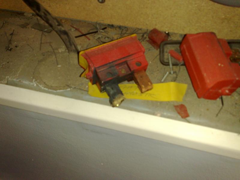

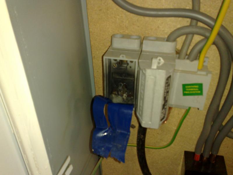

I posted these recently, this is what happened when a colleague on a site replaced a solid link into the cutout assembly onto a dead short.
It could have been much much worse.

A simple case of refitting a loose neutral turned this
Into this in less than ten minutes
This was fed by 400 amp "J" fuses.
There was no isolation between this and the sealed up cut out, one meter away.
All the mcb's were off, usually I megger the spine of the board, before switching on, unfortunately this time I did not.
And as I had only just turned it off, using the test button, I had no reason to doubt it.
As I switched it on It banged and caught fire within seconds and banged and flashed for a further five minutes.
Not something I would like happen again.
The fire brigade took ten minutes.
Edf thirty minutes, by then two phases had eventually blown and one phase was still live.
