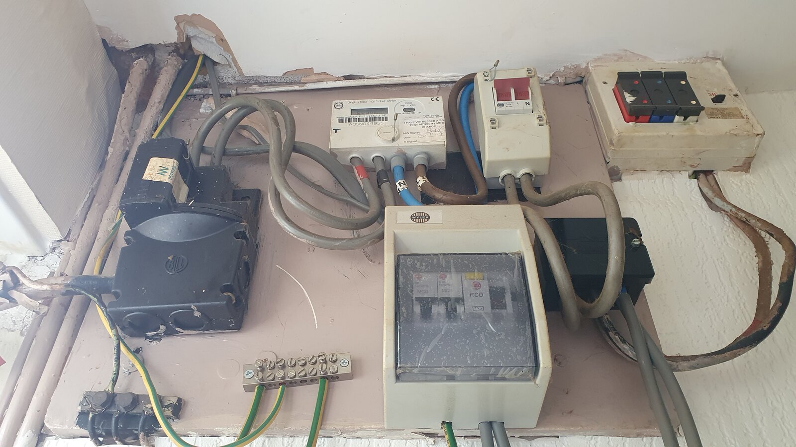

My old fuse box will this always need full rewire when updated to a consumer unit.
No often you can just swap fuse box for a consumer unit, pre 1966 often rubber cables and no earth post 1966 normally OK, there was a short time when Ian Smith was in power we had Ali cables, but need as said some form of inspection first.
Would the old fuse box pass eicr? Or are these banned for landlords?

In general there are several reasons why wiring may need to be replaced.
1. The house is wired in old rubber, old rubber cabling is way past it's safe lifespan at this point.
2. The house was wired with cable from a bad batch. Most plastic-insulated cable lasts a very long time, but there have been bad batches that have not stood the test of time.
3. The wiring was horribly bodged and was never fit for purpose.
4. The usage of the installation has changed and the provision is no longer appropriate.
If one of these problems is happening on a localised basis then a localised fix is likely to be appropriate, but if they permeate the entire installation then there comes a point at which it's easier to just start again.
On the other hand, there are still plenty of properties wired with plastic-insulated wiring in the 1980s, 1970s and perhaps even 1960s where the wiring is still in a perfectly serviceable condition to this day and with a new fusebox and potentially a few other minor fixes they can continue to give many more years of service.
The aren't banned per-se, however they don't provide RCD protection and with the possible exception of upper floor flats lack of any RCD protection for sockets will almost certainly get you an "unsatisfactory" on an EICR.
While there are potentially ways to add enough RCD protection to scrape a "satisfactory" without replacing the CU doing so is unlikely to be a sensible way forward.
My fuse boxes (Wylex) were fed from 30 mA RCD's and all fuses swapped for MCB's so see no reason why it should fail.
