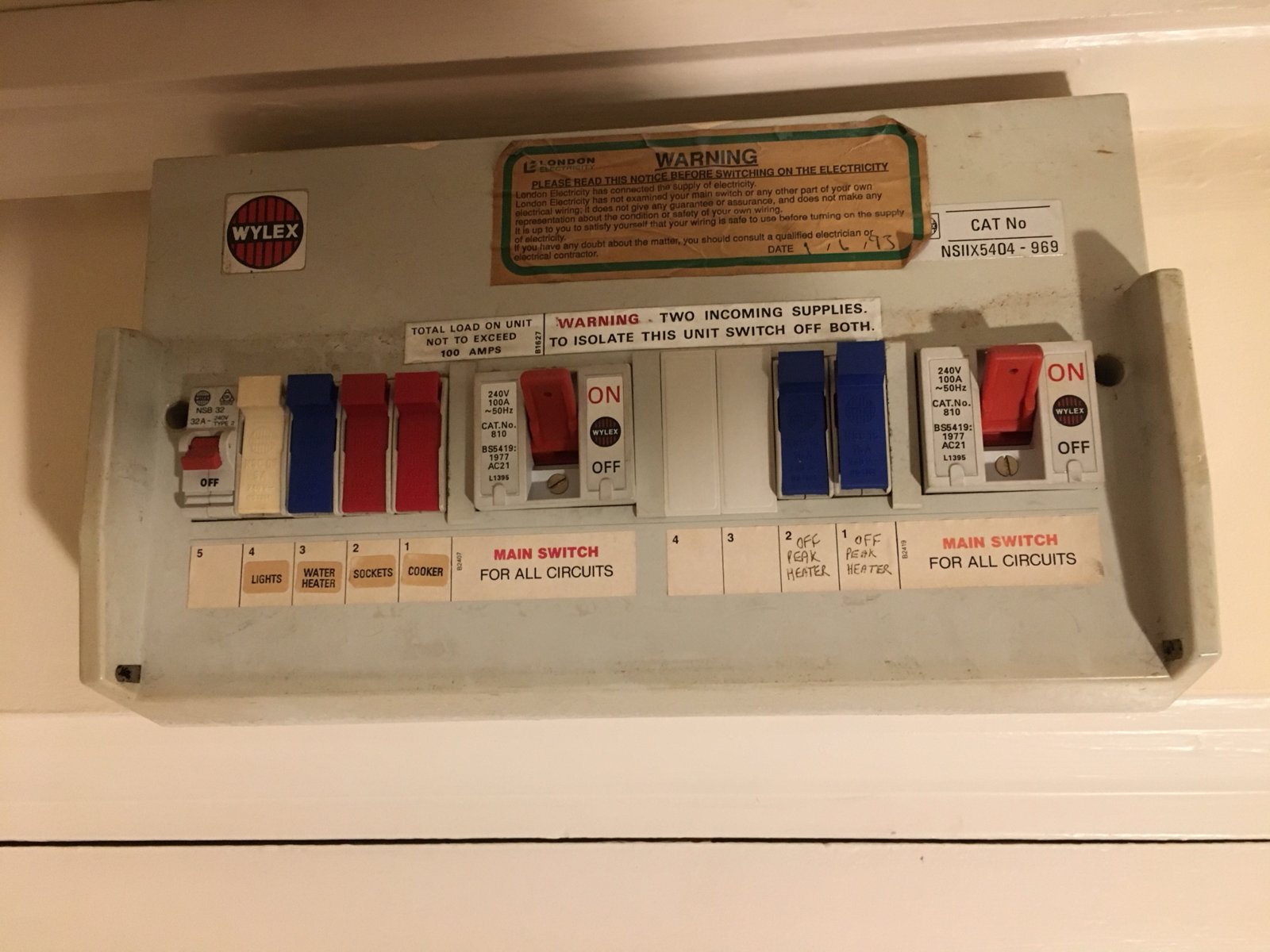

Hi,
I've got an old consumer unit in my flat and the light fuse seems to have gone. Can anyone advise how to replace this fuse? Do I need an electrician? Hope not....
Attached photo of fuse box....
Any help appreciated......

turn off the main switch. Don't pull or replace fuses with the power on. There will be a bit of a flash. Depending on load, it may damage the fuse connector prongs.
Modern breakers can be operated with power on, so this rule has faded from the collective memory.
For that type of CU, you have to buy a spare fuse (unless you already have some). It is not the same as the fuse in a plug. The size varies with current capacity. Like this
https://www.tlc-direct.co.uk/Main_I.../index.html#Spare_Fuse_for_C_and_NSC_Carriers
Buy two spare fuses, just in case there was a fault that is still present. If the new one blows, don't replace it until you or an electrician have found and fixed the fault. Light circuit fuses do occasionally blow when a filament lightbulb burns out, but with modern energy-saving lamps this is getting less common.
You can actually buy a breaker to exchange for your fuseholder at modest cost
https://www.tlc-direct.co.uk/Products/WYNHXB06.html
but you will need a competent electrician to fit it. There are live parts inside the CU even when you turn off its switches.
Thanks everyone......
Got the fuse and lights are all back on.......
A likely guess - one of those lamps which contain a halogen capsule inside a larger glass envelope, GU10 downlights/spots or often sold as 'energy saving' where you replace your old 100W for the 70W halogen equivalent.
Tiny capsule and 230V means filament failure always results in an internal arc to take out fuses and circuit breakers every time.
