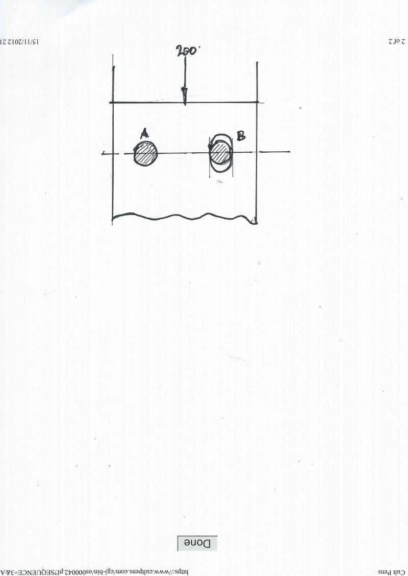

Ronny; an interesting point. FWIW, here's my take on the situation;
Assume you have a 2-bolt connection, and each bolt-joint has a maximum capacity of 100kN. One bolt (A) is a tight fit, with barely enough tolerance, and the other bolt (B) is in a vertical slotted hole. If the pair are loaded to 101kN, then bolt A would fail, and all the load would be on B, which would also fail.
There are 3 ways bolt A could fail; 1. by excessive shear on the bolt; 2. by excessive bearing on the bolt (where the plates can cut through the bolt if the bolt is softer than the plates) and 3, excessive bearing on the plates (where the bolt tears through the plates).
This is of course an extreme case. Bear in mind that most beam/column connections have a minimum 4 bolts, and the tolerances are unlikely to differ that much. The Code states; 'the ductility of steel assists in the distribution of forces generated within a joint'.
The Code therefore allows that all bolts take equal forces (in non-rigid connections). My guess is that you would get some very localized crushing in an over-tight bolt, and the downward movement caused would quickly bring the other bolts into play, thus equalizing the forces. And of course, as you state, there will be a little friction due to the clamping effect, though that can't theoretically be allowed for, except with HSFGs.
I'll have to have a lie down now because my brain hurts :D
Yes, I know 2-bolt connections are horiizontal - as per sketch attached; I was merely making a theoretical point about the loading.

So what do the loading tables say about a vertical slot. Let alone a two bolt horizontal slot.
You should only use slotted holes in High strength friction grip connections. The load capacity is reduced for a vertically slotted hole compared with a standard clearance hole, and must be allowed for in the design.
Although Tony was only trying to show my point that theoretically both bolts wouldn't be bearing, not that a slotted hole should be used in such a connection.
