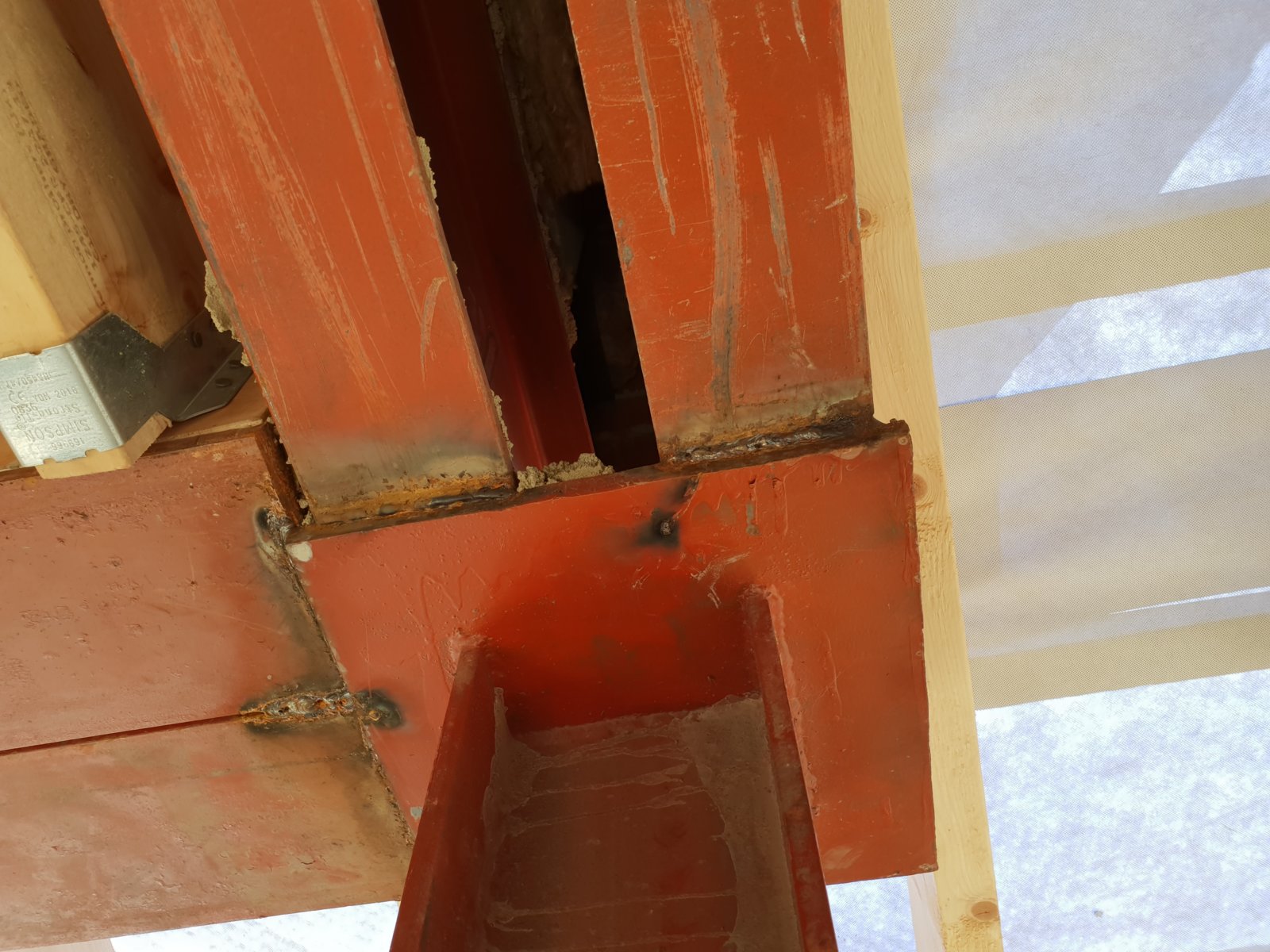

Hi all,
Can anyone tell me if this connection is normal practice.

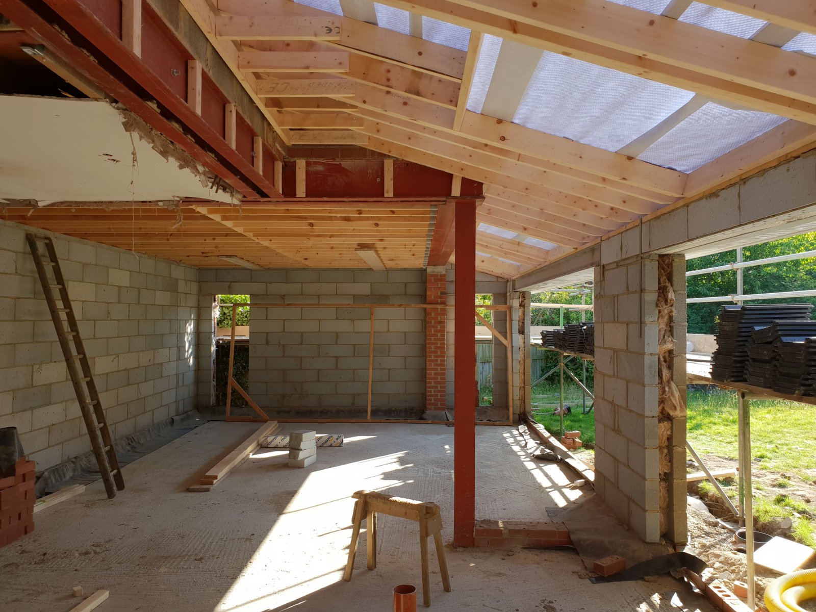

This column has a plate on and picks up 2 twin bolted beams coming in at 90 degrees, as can be seen here...

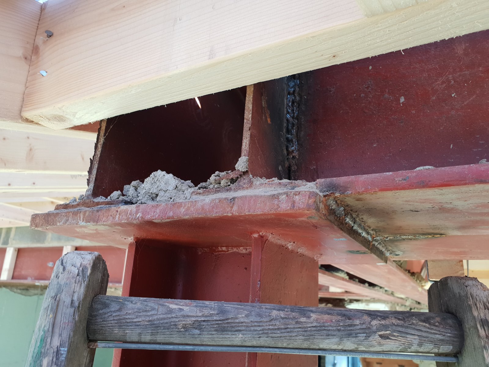

The beam that comes in from the left sits directly ontop of the column welded to the plate. The beam coming in from behind the column in the picture above has its web notched into the other beam sitting on the column. At a different picture angle, this is the beam coming in from the right in this pic...
What I want to understand is if welding (only) is considered a sufficiently strong enough connection and normal practice in these instances?

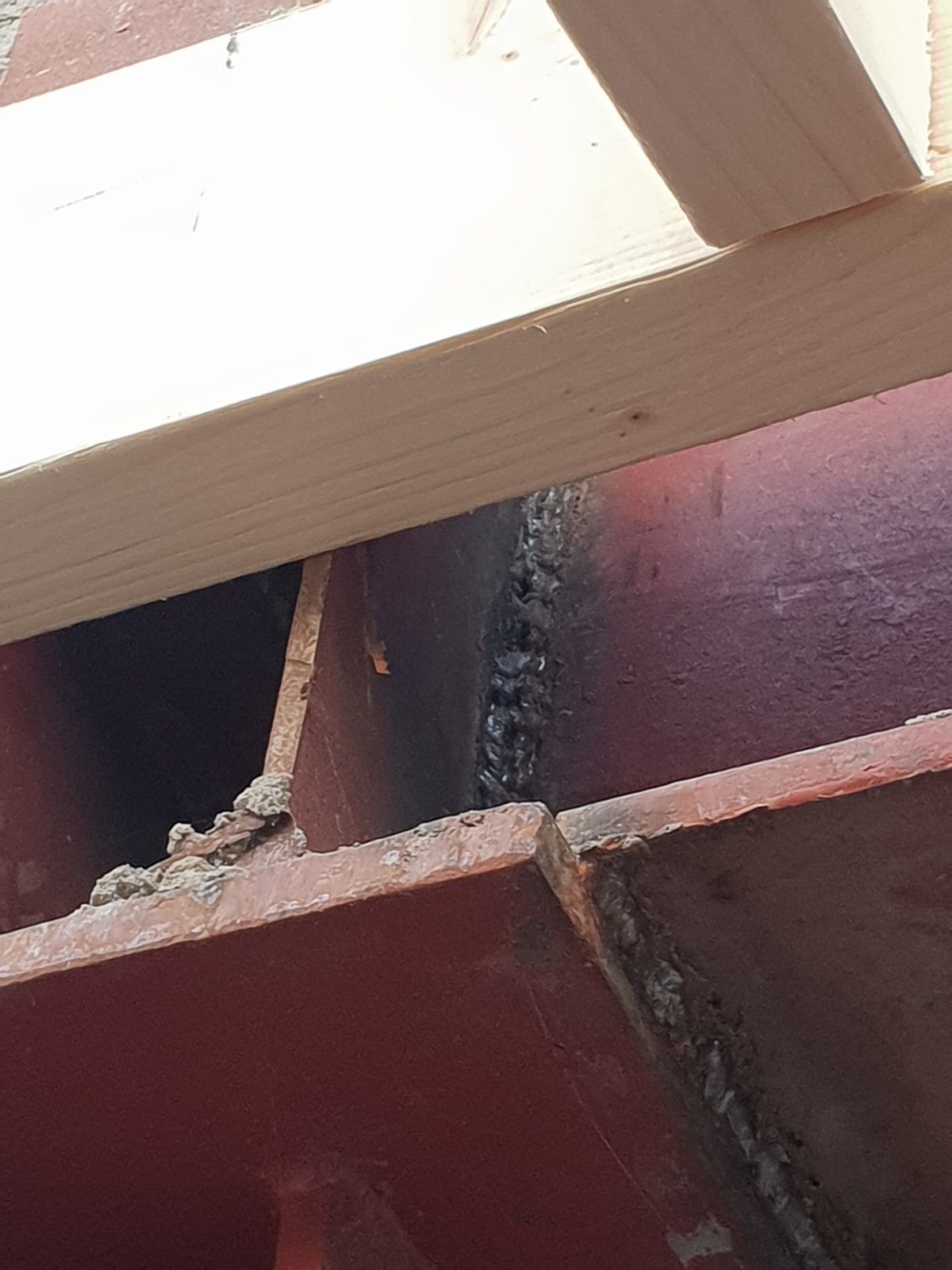

As you can just see, the bottom flange of the beam is welded at the edge of the plate and is only on that plate by a few mm. The flange is then cut and web notched into the other beam and welded to it's flange...

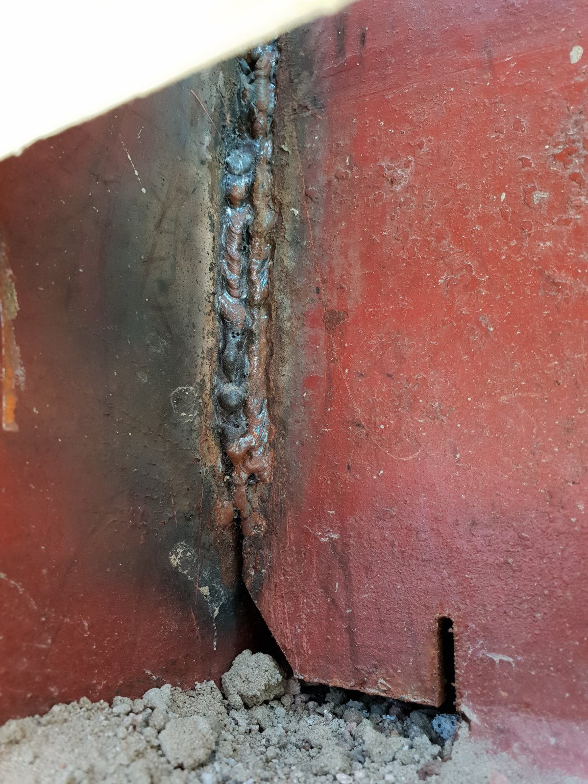

This is the back side of the web where you can see the incoming notched brand have been welded into...

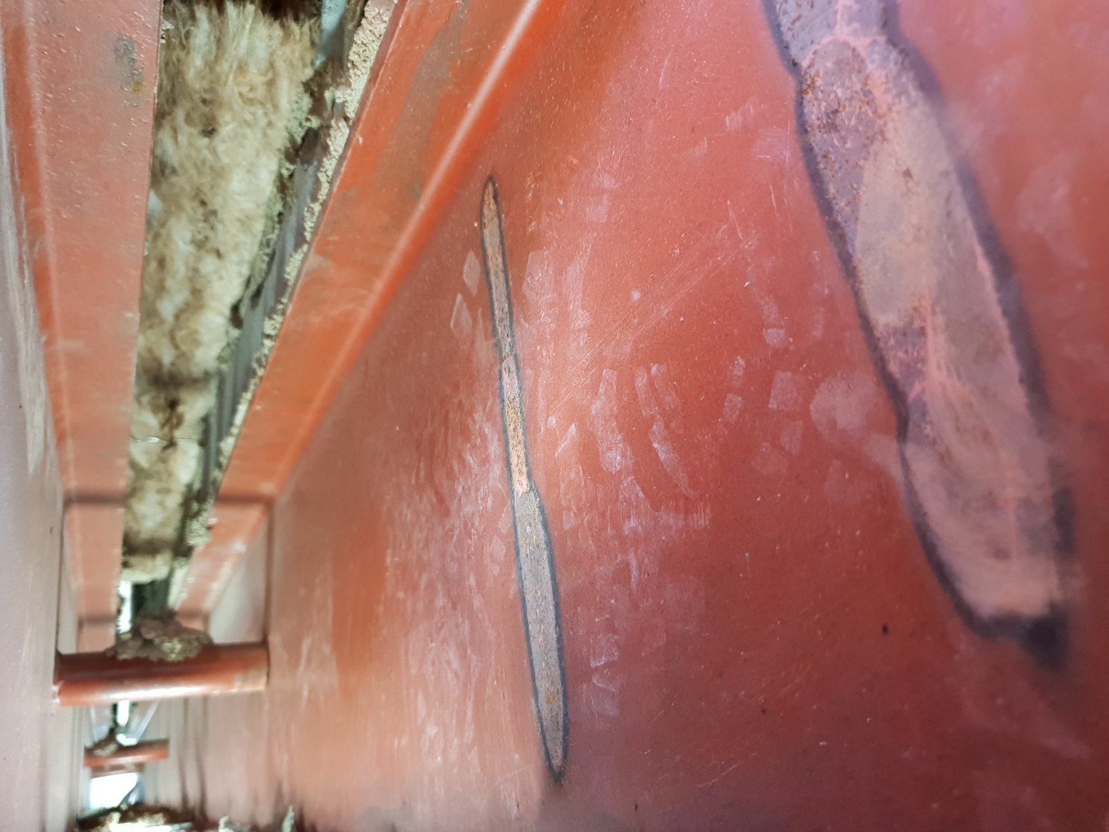

This is the underside...
Basically, other than a few mm welded to the base plate of the column only the web welded to the web of the other beam is maintaining this connection.

what did the SE design? did he specify site welding? I'd have thought not, normally the fabrication place would be better placed to do welded connections reliably. If the welding was specified on site, was the welder qualified for structural work and did he do it to the exact specification. I'd expect the SE to want to inspect.

Those weld beads don't look very neat. Very poor and amateurish. Doesn't even look as though they've made any attempt to clean away the paint, hence the contaminated (scruffy) weld beads.
Awful looking job.
Welds are acceptable connections, but whether they are acceptable in this case is down to the designer.
The engineer should design and specify connections. That's just as important as designing the beams. Can't leave it to the welder to design. The welder is not qualified to design and in this case he's not qualified to even weld.
Welding is acceptable for on site connections, provided the design allows for wlded connections and they are done correctly.
I would say, cleats for joining 1 beam to another at 90 deg is the best way. The cleats can be factory drilled or welded on the end of the beams and then drilled on site for the other connection.

For the OPs connections: site welding is not regarded as ideal, particularly when done by cowboys, as in this example. There is absolutely no way those welds could be verified as acceptable and I certainly would not be happy with them; shop welding of drilled end-plates and site bolting is the preferred way.
