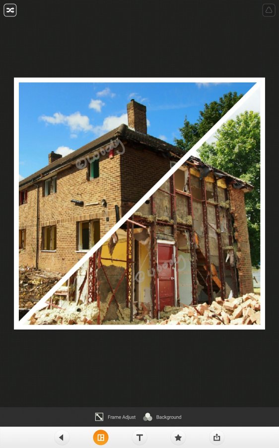

Exposed
Well Woody, seems that one is in needs of some paint .. and doors .. and windows .. and a wall needs more than a bit of TLC
I thought it was Trusteel too, I'd counted the bricks between window and door for the sanction spacing. Looks like a TruSteel MK2 too (?) with steel in the Gable ends. For mine, the gables are standard block and brick cavity with sanction only on front and rear elevation. If it’s looked after it will be just fine (get good value on screap steel, the land is worth more anyway – large plot) .. I'm happy in a lightning storm too :D
