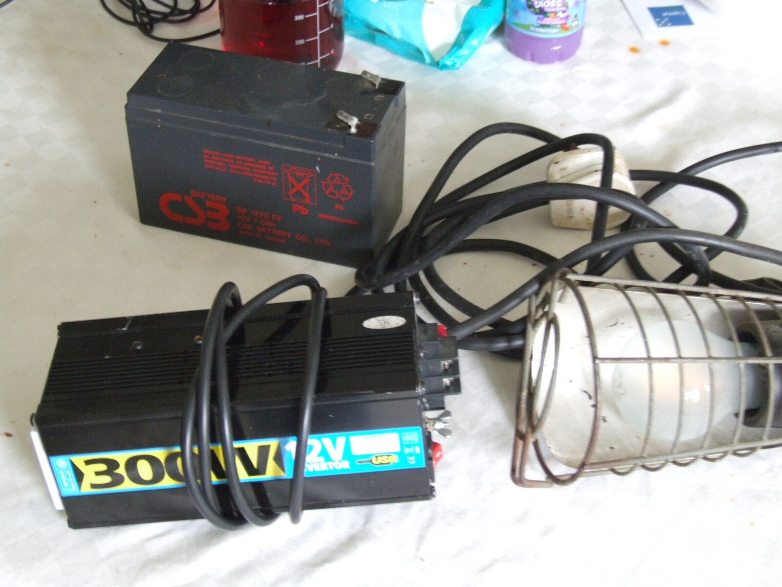

Thanks John, I have a dmm and if it gets serious i will dig the Avo8 out.
Arh well have to put away tonights romantic lighting.
