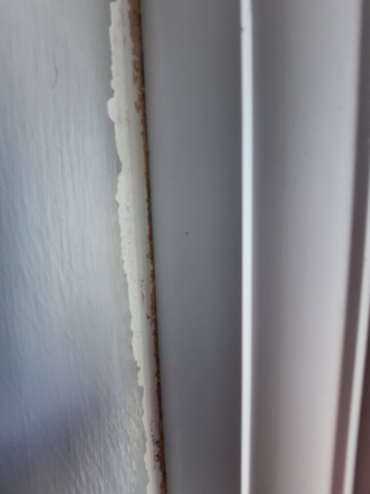

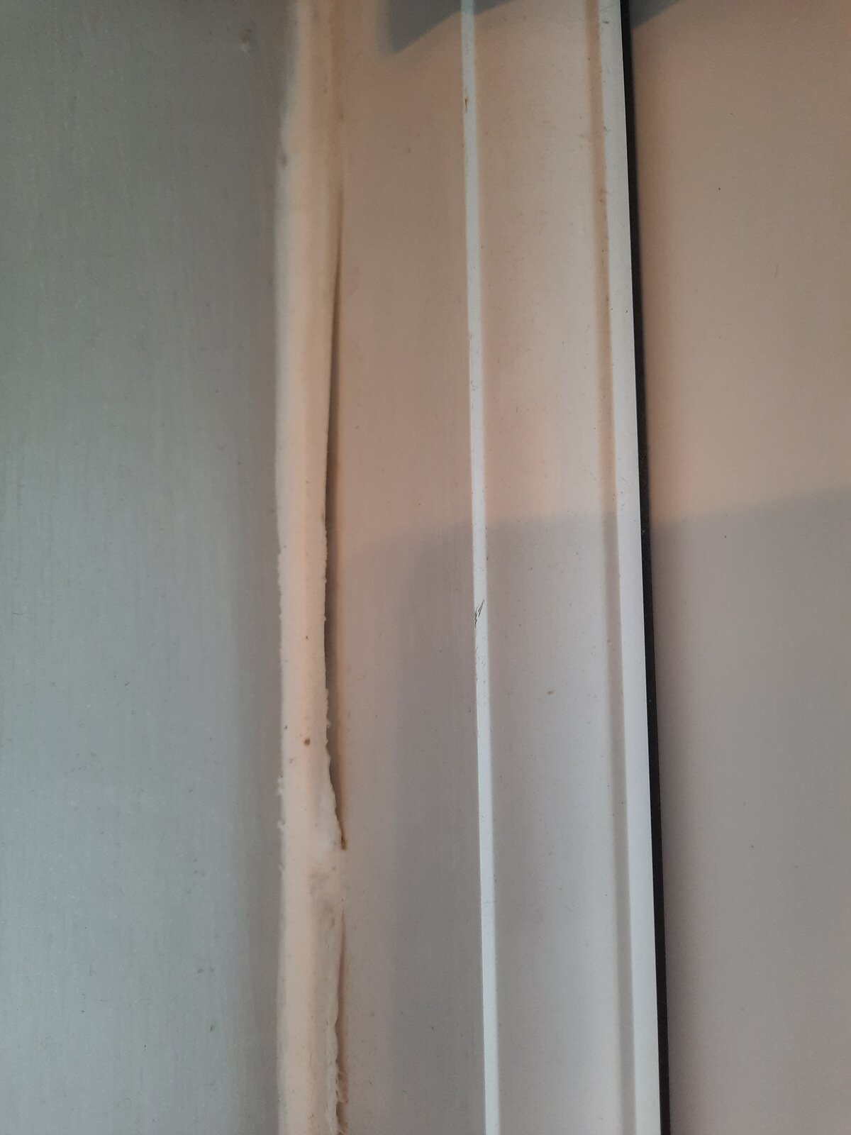

Guys, the silicone bead on one side of our bedroom window is starting to lift a little. Being attached to the window I don't really feel like removing it and redoing it...
Is it possible to stick down some edges which have lifted?
Or, a wider bead over the top, or, something else? Caulk seems a bad idea but I'm not too sure.
Suggestions most welcome, edit, some pics below.

Well it's all (mostly!) out now. Was skankier than I thought and came out mostly quite easily. Now to practice for the more tricky bit
Silicone is the wrong product in the first place. It works well with the uPVC but not with the painted plaster.
They use it because it is cheap, quick and won't shrink back.
IMO, I would rather see them use filler and sand it back when cured but they (understandably) they don't want to return the following day.
They could use MS polymers but they are up to 10 times more expensive (and more difficult to work with).
If you do decide to use silicone again, paint first and then use a silicone smoothing tool (with dilute washing up liquid). Silicone will not stick to dilute washing up liquid.

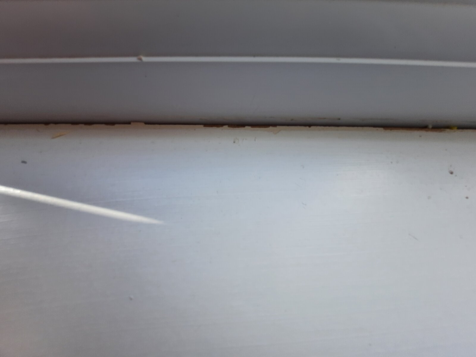

You can dip your profiling tool (or finger) in white spirit to smooth it. If you use filler (and then prime it) you will only need a very small bead of "caulk" which will be much easier to work with. For those kind of gaps, I fill with the likes of Red Devil OneTime or Toupret Redlite. They are lightweight (premixed) fillers. They are quite soft though, so do not be overly aggressive with the nozzle on the caulking gun when it is time to caulk it.
Interesting. The gap is very small all around 1mm at most I'd say.

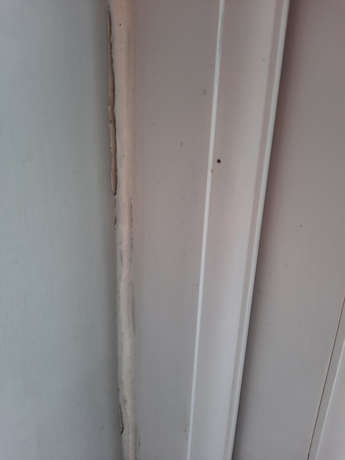

I'll take a picture of the gaps I'm dealing with. I looks much nicer already with the manky silicone gone.
I'd actually say it's less than 1mm. Window ledge to window this is the *widest* gap.
Window frame to reveal, again, essentially no gap.

A very thin bead of that may be enough perhaps. Doesn't look like I'd need an 8mm bead or anything really
I've seen the red devil you mention, which I also saw recommended on some decorating you tube video last night coincidentally.
