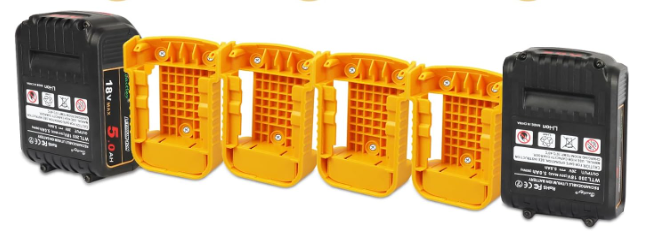

I want to wall mount my collection (small but increasing) of Mountfield Stiga batteries which look like these...
onto something like these, or functionally similar...
Anyone done anything similar, and can recommend a specific Mountfield Stiga compatible product?
Alternatively, which other battery pack manufacturers use a compatible form factor?

i store my dewalt batteries up side down on a purpose made shelve the depth off the top with a groove the catch fits in to hold them safely so they cant slide forward 4x4/5ah on 1 shelve and 6x 6/9ah flexvolt
in your case assuming they have the same slot in the battery space 2x4mm wood screws apart so the head sits in the slot
best to use a say 12mm backing board as easier to get accurate spacing so the screw heads support the battery firmly and level to be pleasing to the eye
