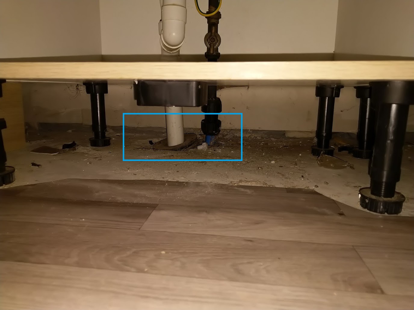

Looking to get some opinions to ensure I'm not missing something before I engage with my landlord about a problem I'm having with a stinky kitchen. We're getting intermittently smelly kitchen, broadly a 'light' sewage smell.
I took the skirt off the kitchen base units to track where the waste was and its directly below the kitchen sink. The 'seal' is just sort of sitting on top of where the pipe enters the hole in the slab with the waste pipe just able to loosely move up and down if I hold it.

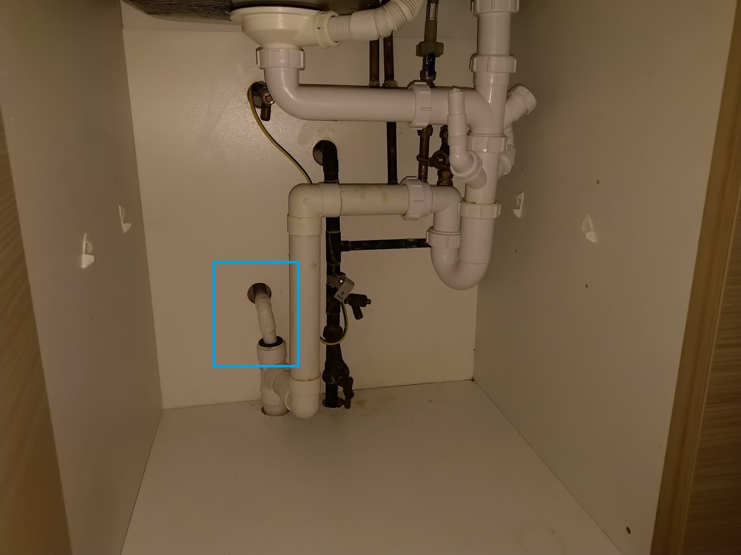

There is also a weird semi-sealed T-junction with a pipe from the wall which is probably the boiler condensate discharge (its comes out of the wall, looks like its supposed to seal, but it isn't sealed as I can easily move it).
Is this likely to be the cause of my kitchen stink?

push the black rubber seal back into position
maybe a plumber or so has been doing something with the waste pipe and dislodged the seal
First picture, the black adaptor should be square on the end on the 4" drain which it caps, looks to me like its been dislodged, (unless the drain is at a funny angle!), you'll need to try and see whats going on, and replace it in it's correct position. May still be some slight movement on the waste, but its designed to seal on an interference fit, so push waste through into required position then leave well alone.
Boiler condensate, if that is connecting into the waste using a rubber boss adaptor, some movement is to be expected, but as long as it is airtight, it should be fine. Whole setup will move at present as the black drain adaptor isn't fitted in/over the end of the drain as it should be, which in turn will hold the waste pipe steady as described above.
