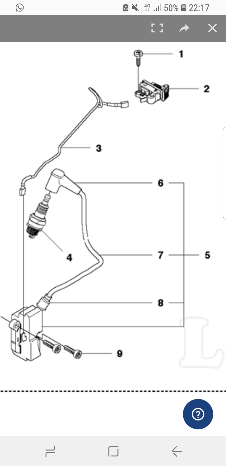

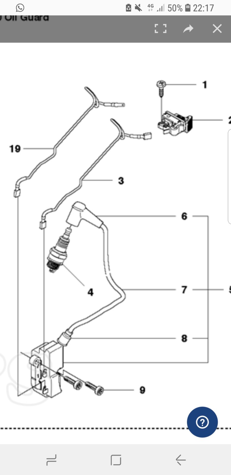

Hi guys my k750 husky saw needs a new coil i have looked on the net and there seems to be 2 kinds for the k750 on with 2 terminals on and one with just one on , i have attached images of the two kinds can anyone tell me what the one with 2 terminals is for ?
This terminal is used to short out the coil and make the engine stop.....this is done by connecting the terminal to earth via the switch. If the machine has a lot of plastic parts its sometimes easier to return to the coil which is definitely earthed, hence the second connection.
John :)
Easiest way to tell what it is you need is take your old one off the tool and compare them.
