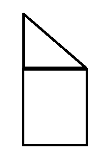

I've got a low outside wall which people keep sitting on.
Whats the easiest way to build up and add a triangular top to the wall to making a pointy edge, to make it uncomfortable to sit on? as per pic
I thought making a timber mould of the shape and making the required sections with concrete , and then when in place have it k-rendered to tidy it up (foam or similar to push into the middle of the setting concrete to make the blocks lighter?) Or is this making hard work of something that has a simple solution

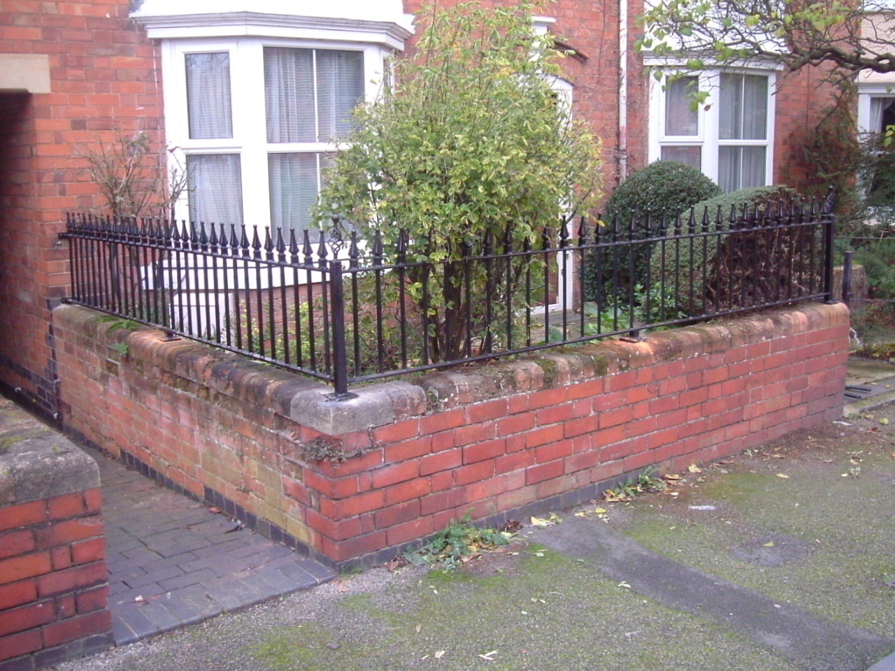

People might still perch on the edge of those
Maybe I should have said, it is a business, I don't think railings will look right, and even if they did - there are drunks and weirdos going up the road (the ones I want to not stop and sit) if someone tripped and impaled themselves, accidentally or deliberately, I'm sure they would sue, so rules that out! Already had to take the barbed wire down on a wall someone got caught on
triangular coping stones?
I did see them, would be something to consider if they were pointy enough and reasonable cost, but didn't seem to be anything suitable. You just have me an idea though, angle grinder cutting thermolite blocks to shape and render the lot?

people will lean on a wall that gives any support would have to be perhaps 32" plus without any change in angle to put them off
Plant dog roses (rosa canina) just inside the wall as they will grow over the top and for a nice barrier.
They are cheap off ebay, prickly, and have nice flowers.
Also consider planting gorse, which is also prickly.
They are both plants with virtually no maintenance needed too.
when I was a kid a householder near the bus stop topped his low wall with bits of broken paving to create a Toblerone type effect.
