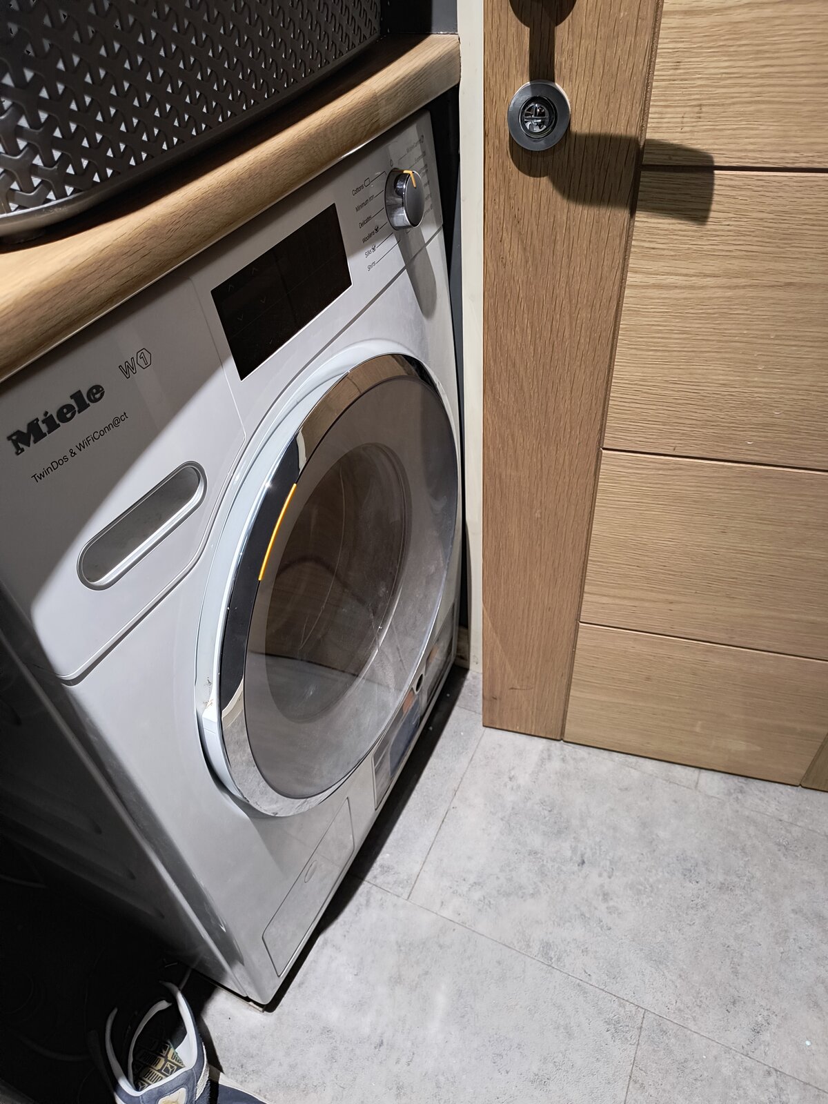

I have a Miele, on a wooden floor. It's a big old thing and until I recently did some work with the pipework at the back to allow it to go further under the worktop there was exactly 5mm of clearance in front of the machine when the outward opening door was opened. In a year of twice daily use it didn't move a mm!
Unless retrained, they all move. Nowt to do with the make or model, just a matter of imbalance, when it comes to the spin cycle. That's why, during the spin cycle, they will frequently pause when they detect a major imbalance, do a few slow rotations to rearrange the load, and retry a spin.
