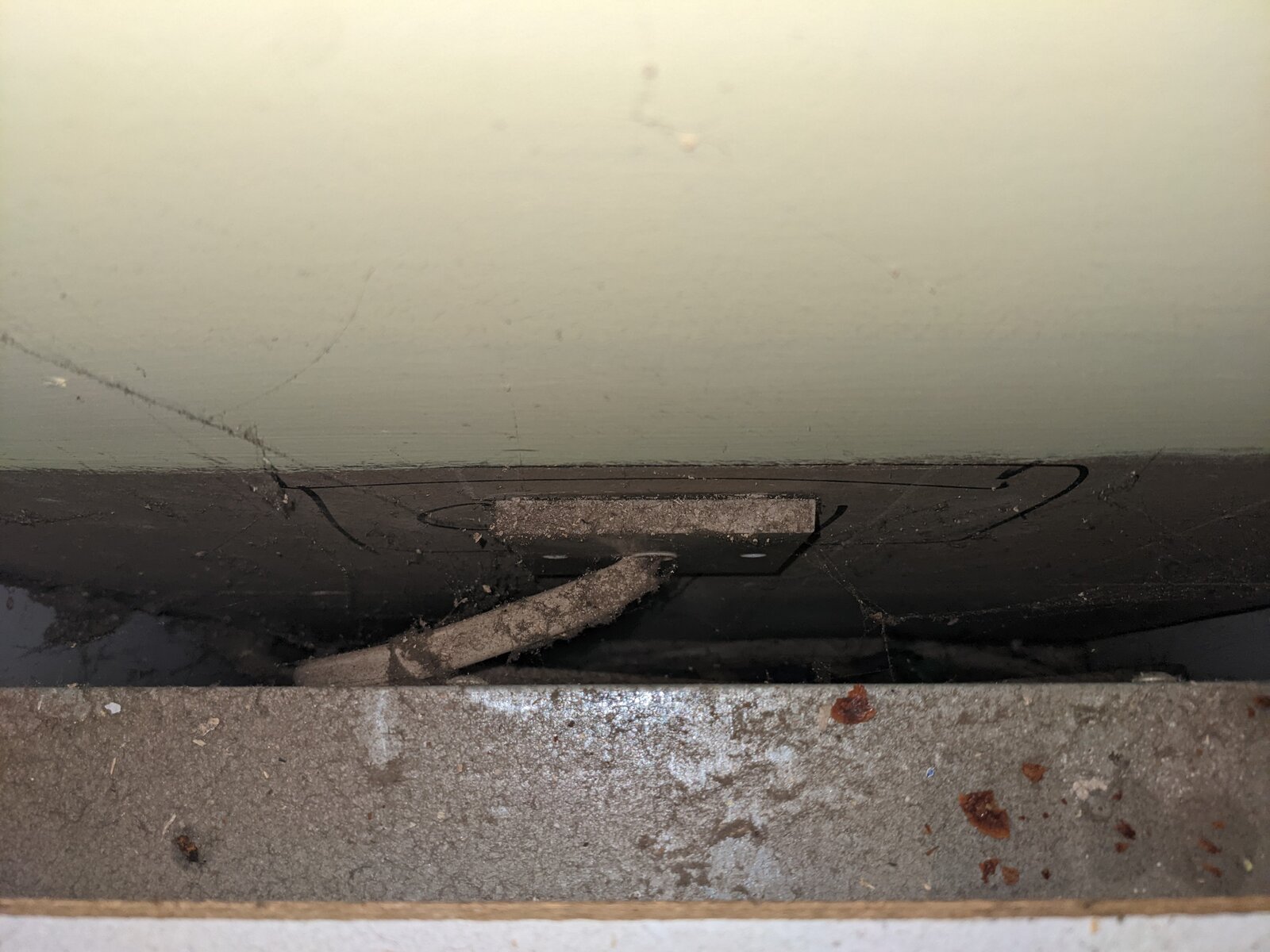

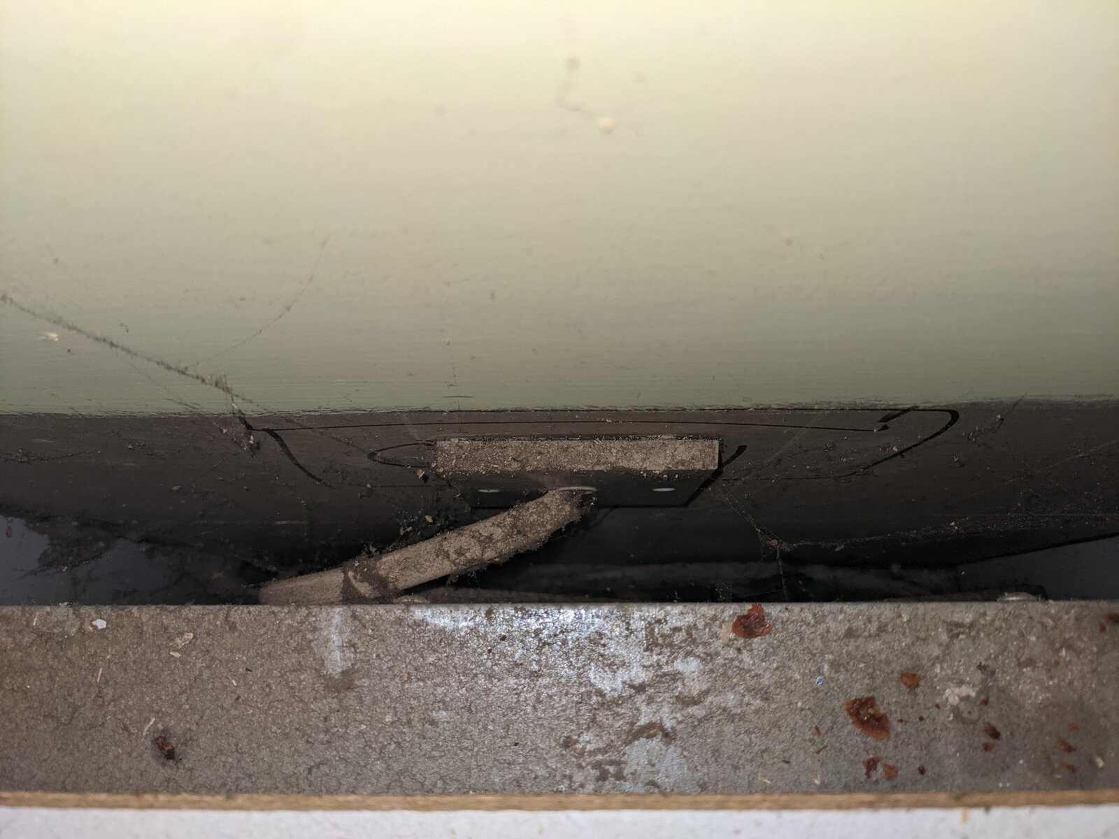

There is indeed a flex connection plate behind the cooker, il leave a photo, the best i could anyway. This is on its own wiring to a 30amp at the fuseboard.
My question however is should i change the flex to a plug socket? Or just rewire to the new oven. Or is there no real point.

....note: the photo is from within the cabinet ABOVE the oven. Where we just have a microwave sat.

The flex on your new oven is not going to be rated at 30A, that's for sure so cutting the plug off etc etc. not a good idea on its own unless you derate the circuit at the fuseboard to 15A.
You could put a 13A socket on instead of the flex outlet but the circuit would then require RCD protection. I think the same requirement would apply if you put an FCU on instead of a 13A socket.

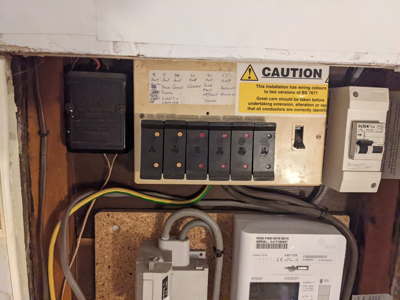

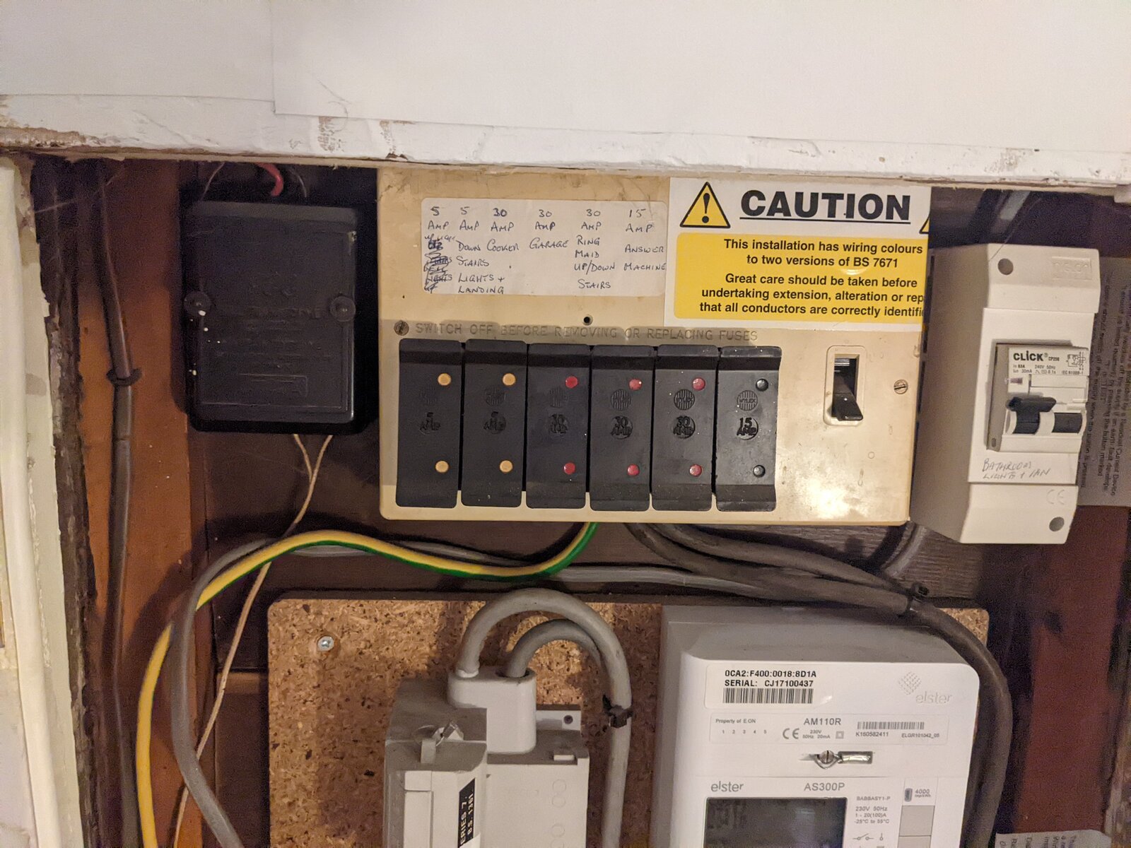

You say fuseboard and mention 30A, makes me think you have rewirable fuses. Are there any RCDs on any of the circuits?

See attached picture of my existing fuseboard.

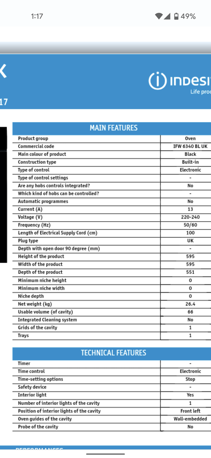

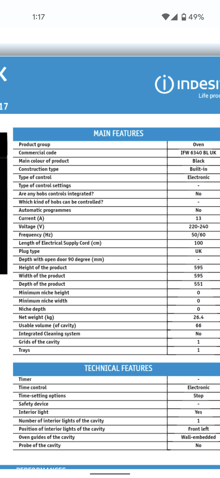

I had alook myself.. is this what you where looking for at all? (See picture 1)

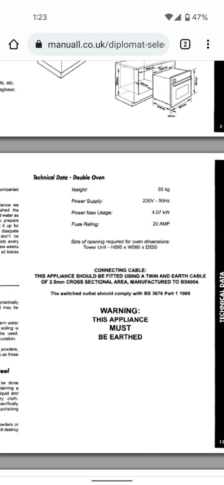

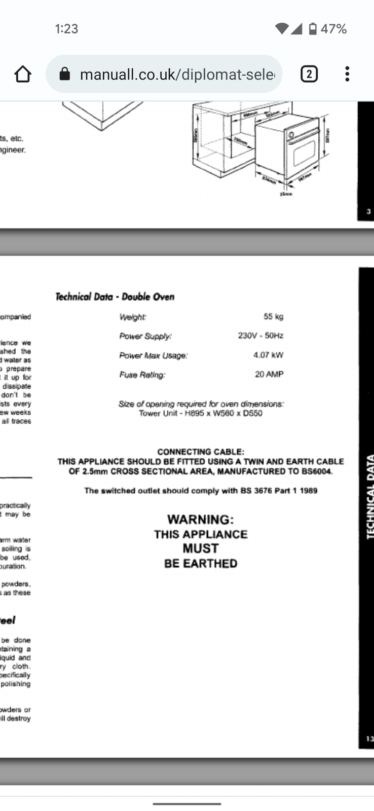

Moreover. I also looked up my existing ovens manual online too, and on the right hand side, you can see the electrical technicals. (See picture 2)

If you see one of my other replys to someone else, i looked for the manuals to both the new oven due to arrive AND the existing. The old one was rated at 20 (i think it said) and the new one to 13.
In the site you linked to, the spec shows it's rated at 13A and fitted with a plug. In my opinion the simplest thing to do is change the flex outlet to a socket.
I can't imagine anyone having any sensible objection, it complies with regs and in my experience it's safer than terminating the provided flex directly into the 30A circuit.

Me neither. But, the photo of his fuse board shows an old style Wylex with no RCD protection on any circuit except for the bathroom fan&lights.
Strictly speaking, swopping the cooker connector plate for a socket would not comply with the regs.

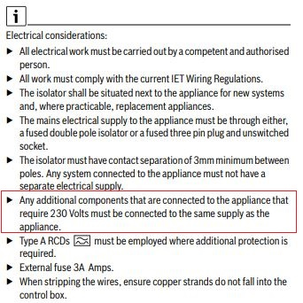

This it seems is from Worcester Bosch boiler, where it states not only is a RCD required but it should be type A. With the comment "where additional protection is required." leaving the installer to find out if additional protection is required.
Personally I think it should say "when using a TT supply" or similar. Through the regulations we have "shall be selected and erected in accordance with the manufacturer's instructions." "shall be selected in accordance with the manufacturer's instruction sheet" "In all cases, the manufacturer's instructions shall be followed." "134.1.1 Good workmanship by competent persons or persons under their supervision and proper materials shall be used in the erection of the electrical installation. Electrical equipment shall be installed in accordance with the instructions provided by the manufacturer of the equipment."

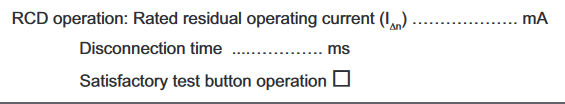

If I was asked to install an oven in that house, it would require a minor works certificate, so question is can I sign this "I being the person responsible for the Design, Construction, Inspection & Testing of the electrical installation (as indicated by my signature below), particulars of which are described above, having exercised reasonable skill and care when carrying out the Design, Construction, Inspection & Testing, hereby CERTIFY that the said work for which I have been responsible is to the best of my knowledge and belief in accordance with BS 7671:2018, amended to .............(date) except for the departures, if any, detailed as follows."
The problem is
and
So I would need to write down why I feel in this case I can do without RCD protection. My own house yes I would do it, and to heck with the certificate, but with some one else's home, where I have no control, I have just read about an EICR done clearly a drive by report, and how the home was sold, and new owners are taking the electrician to court over the report. OK the electrician was a bit silly admitting some of the errors, he shot himself in the foot, but we laugh about jobs worth, but it can be exactly that.
